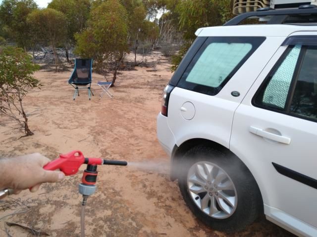

Cleaning the car with pressure air/water is 12 volts at 0.5 litres per minute.
