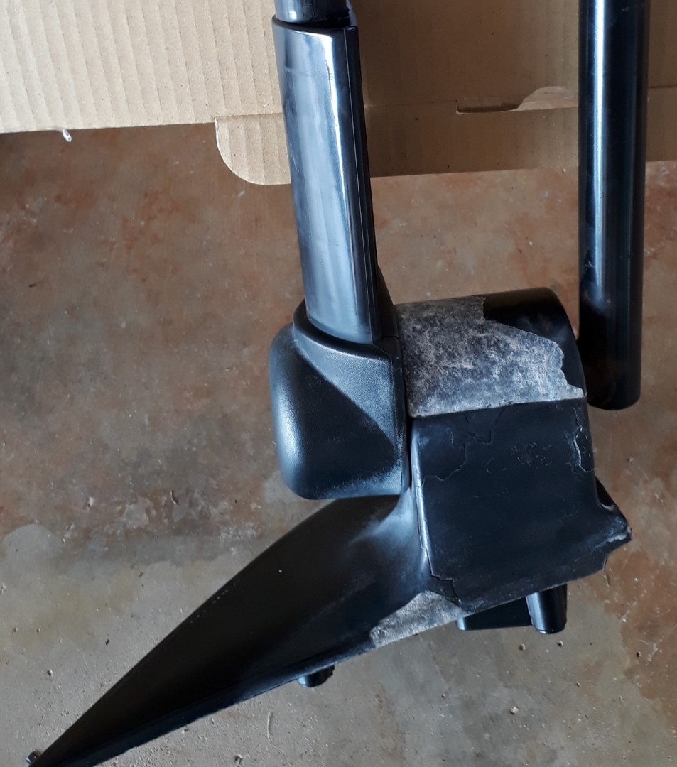

Poor pretreatment and etch priming causes that. Could be just related to the particular batch of powdercoat at the time. Saw this sort of stuff with aluminium windows and would not use small scale powdercoaters as most did not have the wherewithal to regularly get their etch tanks checked by a chemist.
Paulg888 said
03:36 PM Apr 8, 2021
Yes I agree.
Lets hope a company like Clearview will get on top of this.
These mirrors aren't cheap.
had same problem with a ARB steel bull bar. powder coating lifting an water getting under powder coating ,did CLEARVIEW replace them ? ARB'S attitude was it was my bad luck not interested
Paulg888 said
09:42 AM Apr 9, 2021
The driver side base was replaced by Clearview.
But I'm still waiting on a reply to 2 emails I've sent Clearview re the under powder coating bubbling on the passenger side.

When powder coated steel gets messed up, it's often because it wasn't prepped and primed right. Sometimes it's just because the batch of powder coating wasn't good. I've seen this happen with aluminum windows before. That's why I wouldn't trust small powder coating places. They usually don't have someone checking their stuff regularly to make sure it's all good.
LOOKS LIKE THE BLACK POWDER COATING IS NOT ADHERING TO THE METAL BASE.
DRIVERS SIDE MIRROR BEFORE REPLACEMENT
PASSENGER SIDE MIRROR
