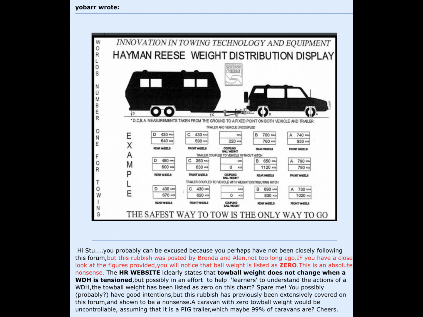

yobarr said
07:47 AM Apr 21, 2021
montie wrote:
As the name suggests a WDH distributes weight from the tugs rear axle to front axle and a percentage to the van axles.
It cannot make weight disappear, if you want that to happen, unhook the van!
Thanks for this post Montie.Unfortunately,it seems that at least one member has a very short memory,or is perhaps being mischievous? Many times I have explained,in great detail,with references to John Cadogan's videos and several publications,that a WDH does NOT change towball weight. Period. Because today I plan to dig,by hand,a 20 metre trench 600mm deep for a power cable,I do not have time to again show facts,so I will post a couple of screen shots from a thread "Towing limitations discussed" that I started on January 1,2021. If,after reading that thread,a person still cannot understand that a WDH does NOT change towball weight,there is little hope for them.The garbage that some write doesn't worry me too much,but I am concerned that newbies will be misled.
-- Edited by oldbloke on Wednesday 21st of April 2021 08:58:29 AM
oldbloke said
08:56 AM Apr 21, 2021
Note each "box" with a weight is directly under where the weight is transferred onto the ground. It clearly states 220kg when not coupled. (weight on jockey wheel) Then when coupled, 0kg on the jockey wheel. (second & third lines) Therefore I believe the image indicates the ball weight although still there has been distributed to the other 4 Axles to the ground. Its no longer on the jockey wheel. So its not nonsense at all, its correct.
Edit to further clarify.
Line 1 indicates 5 points where weight is transferred to the ground, jockey + 4 axles.
Line 2 indicates 4 points where weight is transferred to the ground being axles only. But WDH NOT in use.
Line 3 indicates 4 points where weight is transferred to the ground being axles only. But WDH IS in use
A light bulb moment for some I think.
-- Edited by oldbloke on Wednesday 21st of April 2021 08:59:38 AM
-- Edited by oldbloke on Wednesday 21st of April 2021 09:11:49 AM
montie said
09:07 AM Apr 21, 2021
Oldbloke,
Firstly you need to contact HR and inform them of this error as they do state the direct opposite on their website.
Secondly a hitched van with a zero ball weight would be untowable.
Thirdly why do I get the feeling that you already know all this.
oldbloke said
09:13 AM Apr 21, 2021
Monies, reed my editing.
Clarky 1 said
09:19 AM Apr 21, 2021
Yobarr,
You know what, I recon I know you from older driving days. You have quite a reputation and you certainly haven't changed, Chris P.
Your pic of mine from a Hayman Reese website is unfortunately lacking the circled yellow display of the coupling ball weight when the WDH is connected. You may not want anyone to see that detail.
After you dig your hole do you think that you could supply for all the members on here ACTUAL WEIGHBRIDGE PROOF that the amount of Tow Ball or coupling weight DOES NOT transfer to the front axle and van axle.
Dont come back just waving your arms and crying that you know better than anyone else. Come back with WEIGHBRIDGE PROOF.
Here is how you do it just in case you are confused.
Weigh each axle of the tow vehicle.
Weigh the axle group of the van.
Weigh the tow ball weight of the van disconnected from the vehicle.
Connect the van to the tow vehicle.
Weigh each axle group again with the WDH correctly installed.
Record the increase in the front axle.
Record the increase in the van axle group.
Inform us all that the sum of the amount of the increase in both axles is equal to the original ball weight of the caravan or trailer.
There is NO WEIGHT LOST FROM THE GCM.
It is moved TO THE FRONT AXLE OF THE TOW VEHICLE AND TO THE AXLE GROUP OF THE VAN FROM THE TOW BALL.
The weighbridge exercise proves this.
oldbloke said
09:34 AM Apr 21, 2021
To perhaps further clarify. The 0kg indicate the jockey wheel is no longer under load. The TBW has now been transferred to the other axles.
The image is IMO is correct if taken in the context that they are weights under the Tow ball and axles.
Even the yellow high lited statement says the TBW is still there but now transferred to the axles. But this needs to be read in context.
Once the van is connected to the car the TBW is immediately transferred (mostly) to the rear axle of the car. The WDH distributes that TBW weight more evenly over 4 axles.
So, without a WDH, with or without an up grade or air bags IMO the steering will still be compromised. Reason being the rear axle is still taking most of the TBW. Therefore some weight is removed from the front axle.

Here is a post from another topic that I posted indicating Hayman Reeses explanation of how, when on a weighbridge it is proven that the weight is transferred to the other axles while using a WDH.
Oldbloke,
