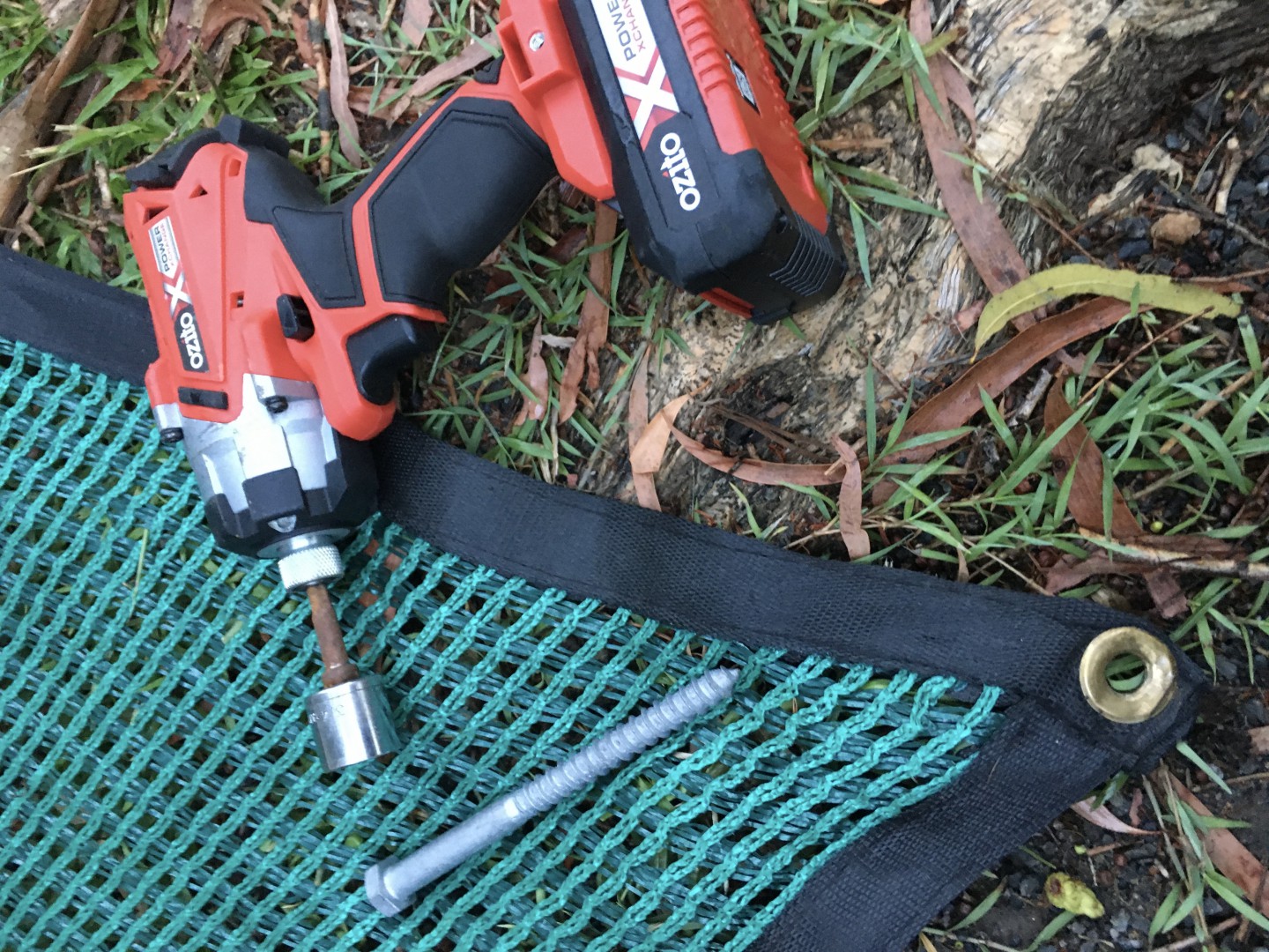

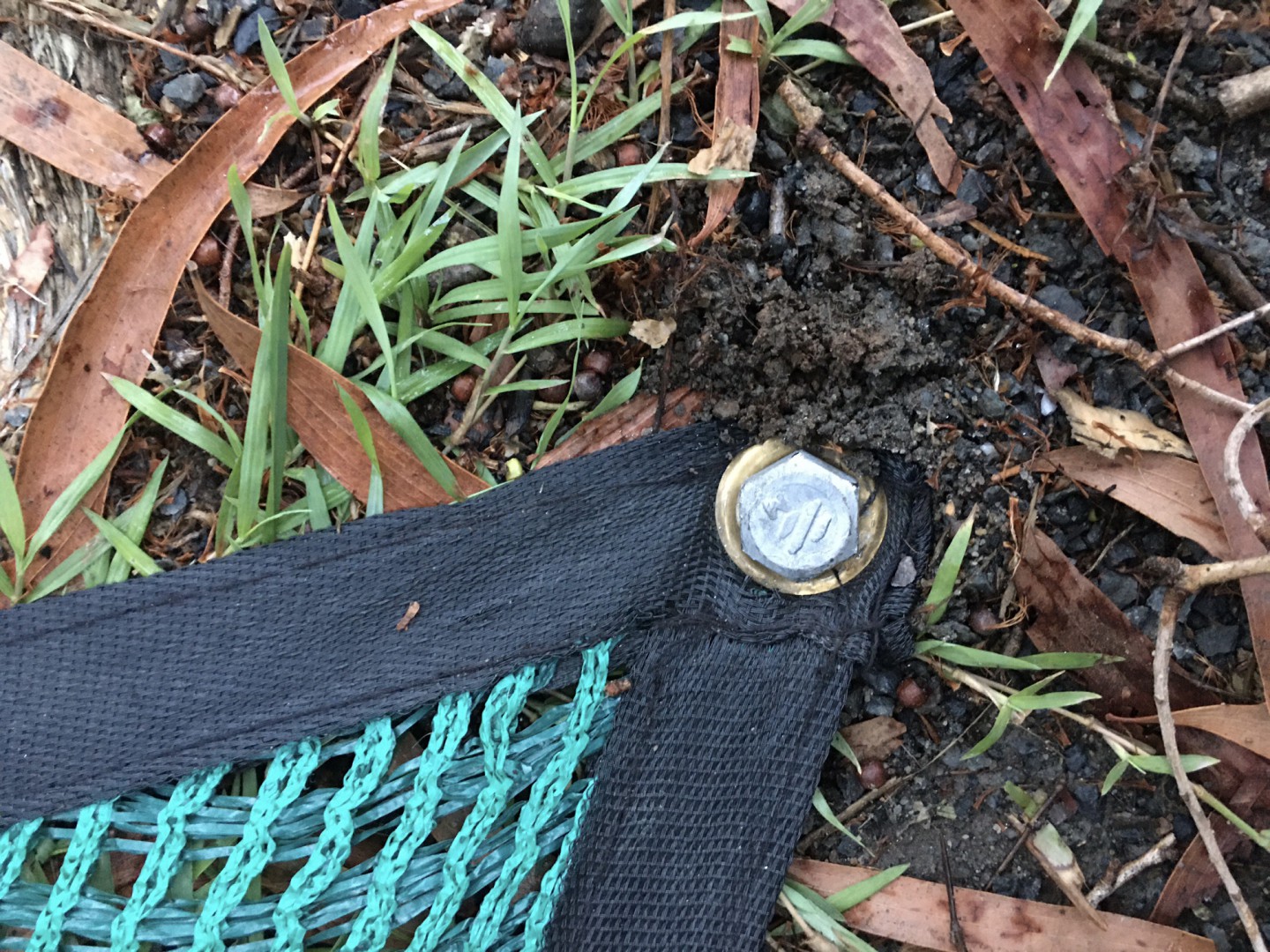

I was browsing Bunnings camping products online one night and saw their tent peg and rope kit. In it were 6 plastic pegs, 6 steel pegs, and 6 screw like pegs. So on a gamble, I bought 6 galvanised coach screws with 3/4 HEX heads, as they looked far bigger, and better, but because they weren't "bonafide" screw in pegs, I wasn't sure if they would actually work or not. So I've just tried them out this afternoon, and they are absolutely awesome. (They only cost a few dollars each).
I camp at Bramston Beach a lot, (an hour south of Cairns), and using tent pegs here is a nightmare. The ground is compressed rocks, and where there aren't any rocks, there are tree roots. I am always bending ultra heavy duty pegs here, but these babies went straight in without any effort. (They especially loved the tree roots, lol). It took less than 30 seconds to buzz them all in with the impact driver.
I bought the largest I could find that would fit through the eyelet of the groundsheet that goes under the awning, but smaller ones would work, depending on your application. (They wouldn't be functional in sand or mushy soil, but most places I go have rocky, crusher dust type ground).
I'm going to make 45 degree brackets with holes drilled in them, so they can be used to hold guy ropes, and be done with pegs forever. The other bonus, my dogs can move around camp without their leads getting snagged, and you don't have the nightmare of digging away to find a leverage point to remove them like you do with pegs. Just reverse them out
I hope this helps

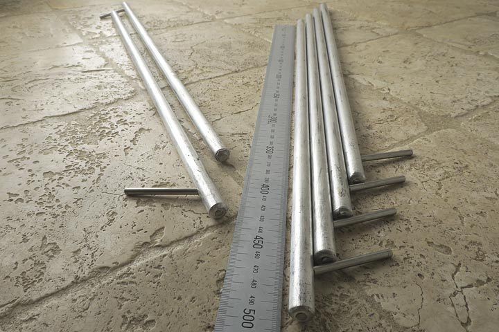

At the end of the day you need a range of pegs for hard & soft ground. I knocked up these aluminium & stainless steel pegs for softer ground to save weight.
I hope this helps
