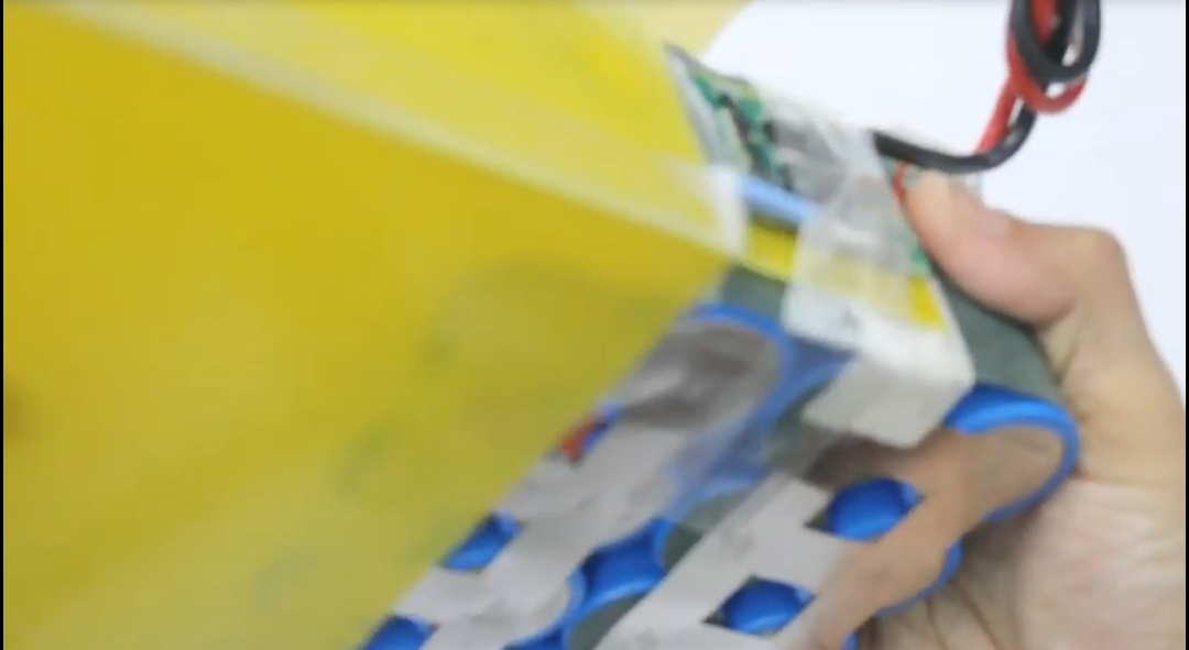

This battery pack is 24Ah 2.464kg. Not large enough for an auxiliary battery. But with minimal casing it still works out at 10.266kg for 100Ah.
This is a good video 12m26s, you can whip through parts quicker, but, there is some good explanation & testing of one cell on a testing device icharger X6.
Is was noted that only one cell was tested, nevertheless it had a disappointing capacity. A reasonable BMS but it was covered so cooling is not good.
A bit of insight for us novices to arm ourselves!

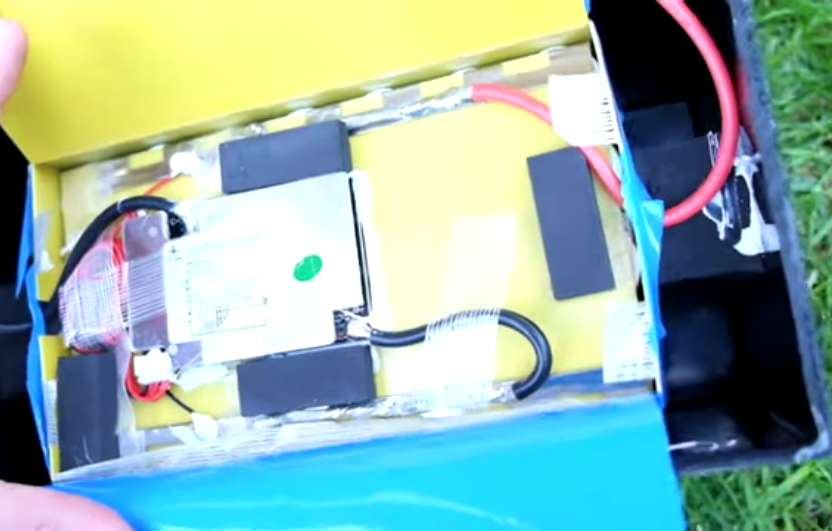

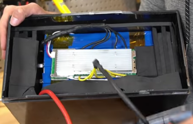

Inside a Voltax battery, lots of air & a small battery.
Examples of what one may find if they open up a lithium battery. Good, bad & not even heavy enough for a door stop!

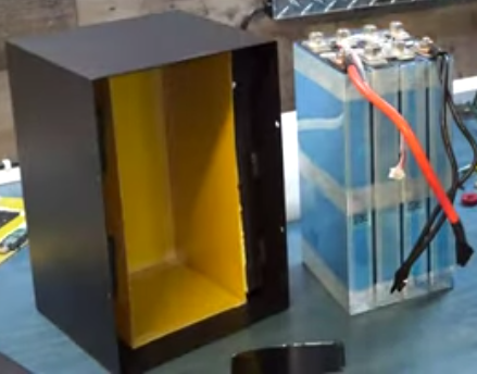

Victron
Some examples at the other end of the spectrum:
https://m.youtube.com/watch?v=ImF1S730bFM
https://youtu.be/-gH_ZRqHYtk
https://youtu.be/j88H79qjdqs
