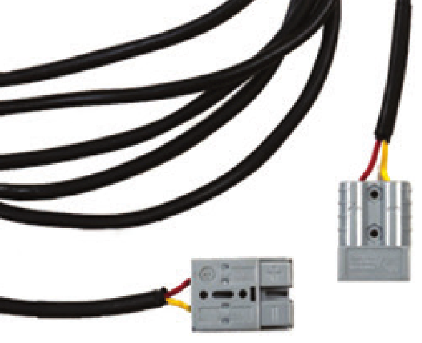

When I look at the price point of these products something has to give, & it's probably a bit more than just wiring.
The 160 watt PWM model I would suggest the wiring is a "touch" undersize! My guess is about 14awg wire at best, so there goes 10% of your power straight out the window over 6m (12m + & - )
My 20 amp MPPT was over $200, let alone 6awg & 4awg wire, plugs & solar panels.
