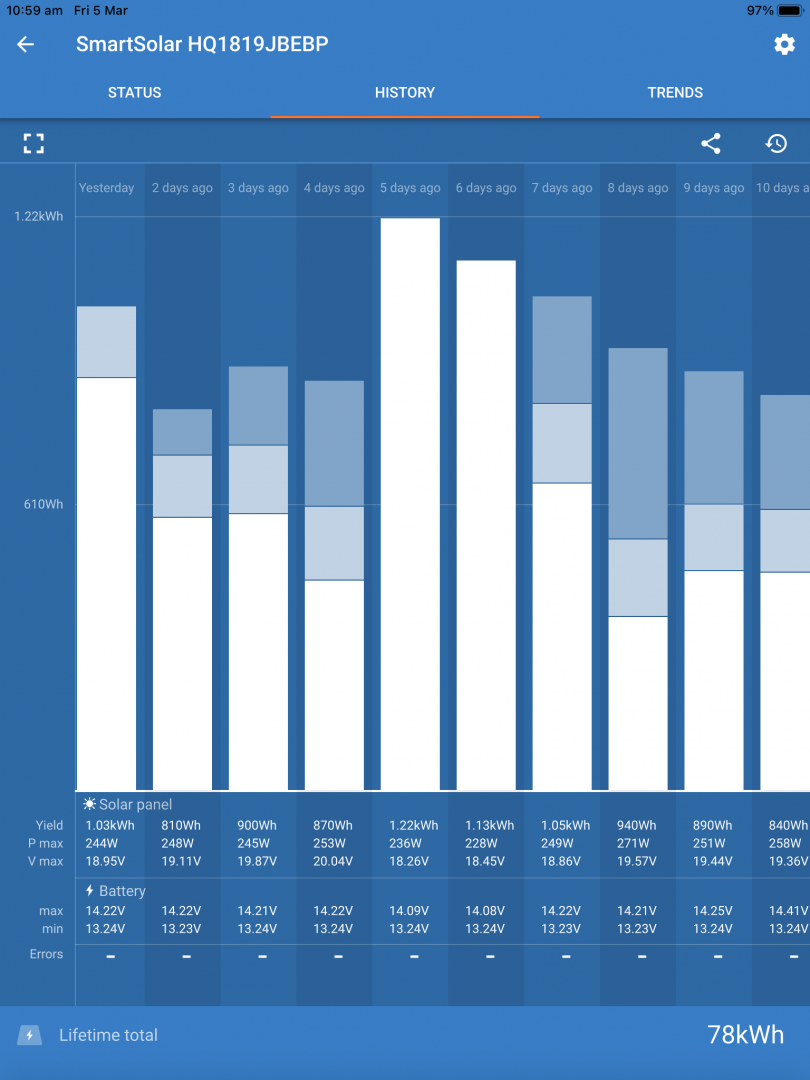

I just thought I would post my limited experience with lithium batteries and solar panels etc.
Caravan is a 2016 so called "off road" model with a large compressor fridge.
Originally, I had the "standard" 2 x 120ah AGM batteries with 2 x 120W roof mounted solar panels.
A couple of years ago I changed the original PWM solar regulator to a Victron 100/30 bluetooth model, and added a 200W semi flexible solar panel to the roof.
This worked ok most of the time, but often I would need to get a portable 160W solar panel to help on some overcast days.
Anyway, to cut a long story short, over the 5 years I've had the van, I have needed to get my "back up" portables out more and more often.
Ok, time to get some new batteries, and maybe go lithium this time. Well I don't know how much research I did on this subject, but I know it was a lot!!
It come to the stage I was sick of looking at batteries day in day out, so I either had to make up my mind soon, or go down the AGM path again...
Anyway, I ended up getting 2 X 100AH Voltax LifPo4 Plus batteries from eBay, and then proceeded to fit them to find out if I had blown my $1145!
All went well with the fitting, and they are certainly a LOT lighter than the originals!
After fitting, I moved the van out of the carport to see what they could do, and was impressed so far.
Now I am staying at Walker Flat SA to give them a REAL test, and things are looking very good. I haven't had to get the extra panels out. Mind you, the weather has been excellent with probably only one overcast day so far.
I have put a couple of pics up, and some info from the victron to show how things are going.
I have no affiliation with Voltax or Victron, these are just my observations, and to try and give an insight on what you can expect with minimal outlay. I know it's early days yet, and I will update every 6 months or so.
Thanks for taking the time to read.
-- Edited by woofta and precious on Friday 5th of March 2021 02:01:31 PM

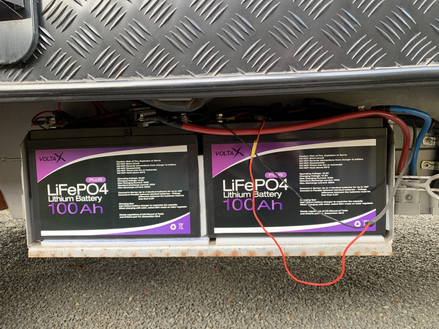

Is that an open box on the caravan, wont they get knocked off from there. I would have some sort of locking feature, or enclose them in some way to stop it from happening. Because lithiums are expensive, and some ratbag, is going to have ago at knocking them off mate, I am sure. Another issue, those wires hanging down, if you do some bush work, those wires are sure to get ripped off. Other than that lithiums are what I am going to get for my camper.

Sorry, bicycle camper, I took those 2 photos at the time I installed them.
I had the door off the battery compartment with a few wires that I hadn't connected up yet.
The door is normally locked up with a large padlock.

Are we to understand that you have 440W in 3 panels on your roof (2 x 120W + 1 x 200W), and that these are producing around 250W on a sunny day?

woofta and precious said
02:53 PM Mar 6, 2021
Hi Dorian,
Yes, good pick up on the max. watt output.
The way we are camped up here at Walker Flat has something to do with that, as we are facing north to the river (looking out from awning). There is also a line of trees running along the river, which I have tried stay out from as much as possible, but turns out it partly covers the 2 panels on the door side of the van.
As it turns out, I still get enough to get into float most days, and when I don't, it doesn't seem to matter too much.

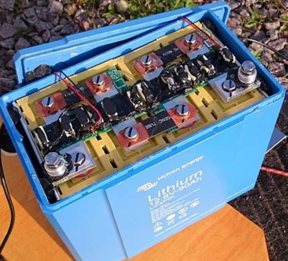

09:03 AM Mar 16, 2021
Voltax vs Victron 100ah
9.5kg
330.3 x 173.4 x 215.6mm = 12.348 litres
0.769 kg/litre
Standard charge 40 amps
Maximum charge 100 amps
Discharge 100 amps
15kg
321 x 197 x 152mm = 9.612 litres
1.56 kg/litre
Standard charge 50 amps
Maximum charge 200 amps
Discharge recommend 100 amps
Discharge max continuous 200 amps
It would be interesting to open a Voltax & see what's inside.
I suppose if you were boating at least the battery would float!
-- Edited by Whenarewethere on Tuesday 16th of March 2021 09:07:57 AM

Personally I would not touch this stuff with 2 barge poles in series!
If I did get one I would start by drilling a hole in the top at the corner & spy inside. Obviously something that can be plugged.
My personal believe is that there is a smaller battery in a larger outer case.
I am more than happy to be proved wrong.
Good catch. The 100Ah Voltax weighs the same as a 60Ah Victron.
'The next generation of power storage is here! These LiFePO4 batteries weigh less than half of their Lead Acid counterparts. They may look fairly similar to lead acid batteries, but internally they're a totally different, next generation concept. They're actually made up of regular 26650 LiFePO4 cells, which are in mass production for many portable devices. An internal battery management system (BMS) ensures all cells are uniformly charged and discharged, as well as providing short circuit, over current, and reverse polarity protection. This provides you with a higher degree of protection than a traditional lead acid battery which is unprotected, and can discharge rapidly under short circuit conditions, causing fire and damage. The internal BMS will also limit discharge and manage cut-off voltage, to further protect the internal cells.'
https://www.victronenergy.com/upload/documents/Datasheet-12,8V-&-25,6-Lithium-SuperPack-EN.pdf
I would measure the dimensions of the panels and do some calculations there as well.
This might give some insight into what's inside.
https://www.lithiumbatterypower.com/blogs/news/do-you-know-what-s-inside-of-that-lithium-battery
Inside a Victron:
A teardown of lithium battery.
https://youtu.be/-gH_ZRqHYtk
Powertech battery
https://cometbattery.com.au/shop/commercial-batteries/lithium-deep-cycle-battery-12-8v-100ah/
Another teardown.
https://youtu.be/WjPCo7fT0Tw
