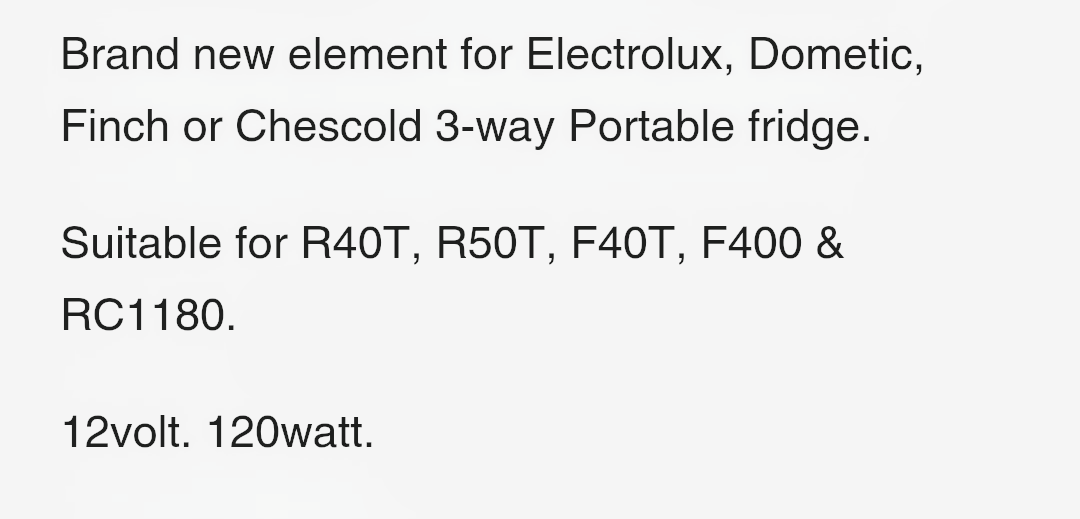

12:35 AM Dec 11, 2020
A replacement element for the Finch fridge seems to be 120 watts which from my understanding run pretty much continuously.
