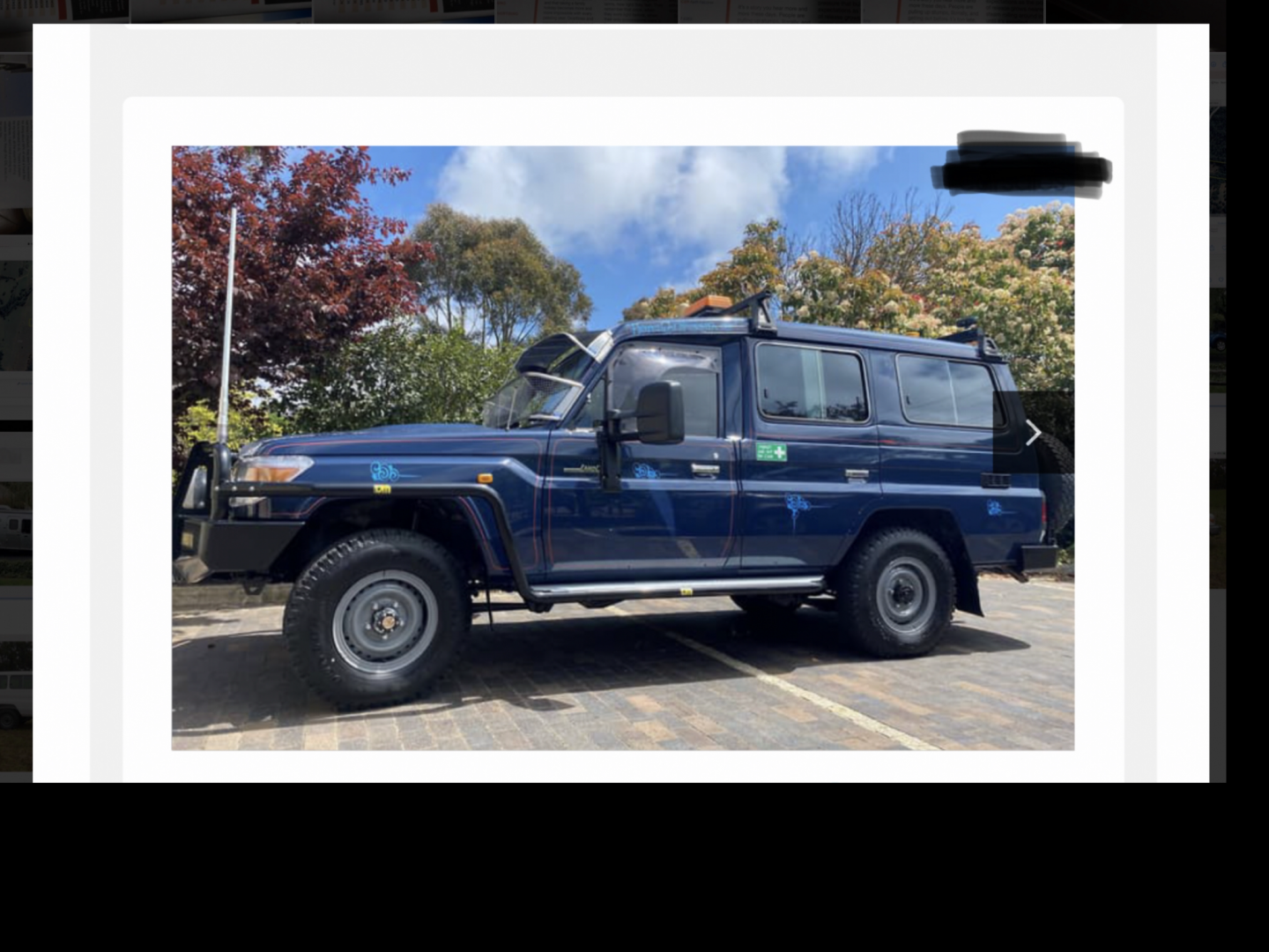

A few weeks ago, I caught up with an owner of a near identical TD to mine and we compared our setups. The only real difference to running gear was I have an optional 4" lift and a DO35 on mine while the other uses a McHitch. Mine is towed with a stock height 2013 Hilux, the other with a lifted 2009 DMax. Side by side, mine rides level and the other is about 150mm lower at the rear even though hitch height is within mm of each other. Ride height is not an indication of load, tbm or any other mass but almost exclusively geometry.

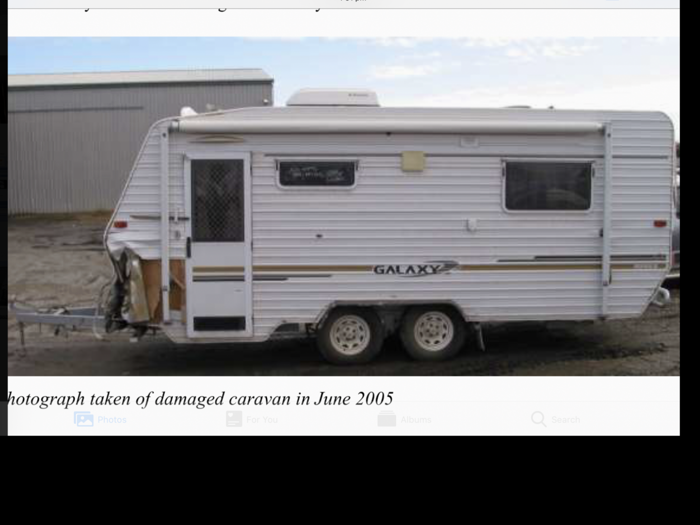

This is the result of zero ball weight....... Notice that the caravan sits level,without a jockey wheel? When the vehicle towing this van was unsettled by an overtaking semi,the whole lot overturned,sadly resulting in three people losing their lives.Cheers
Your last sentence says it all....
