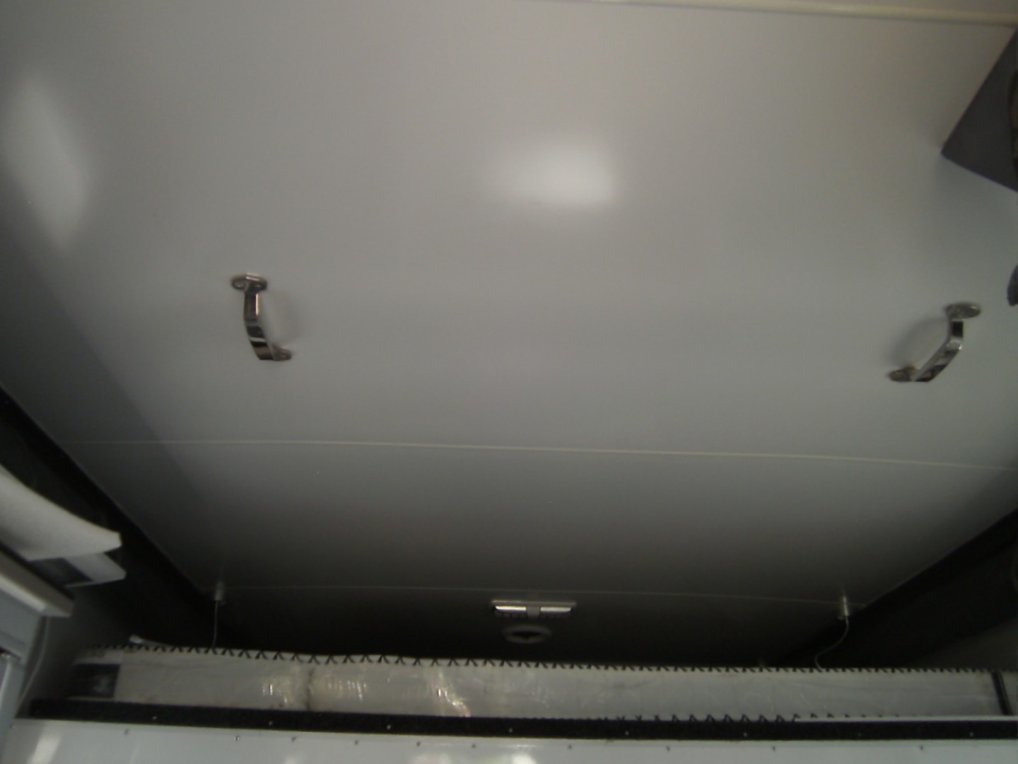

I just tried to raise the roof on my new (Chinese made) slide on camper, for the first time. I don't have the strength. I'm 64 years old, 5'10" tall, mild build male, and I could not budge it (and yes the corner clips have been released). Could be that its sticky as its not been raised since made, but I'm now wondering if its even got gas assist struts?
At home (in order to raise it and see whats going on), I'm thinking of putting a wide timber brace across the floor and another across the roof and using a car jack (I don't have a crane). Probably my only option, unless I hire two strong people?
Any ideas out there?

Thanks everyone. Just has two handles in middle of the ceiling. I can feel 2 gas struts through the skirt each side.
It may be that the struts are seized attempt to get some silicon spray or WD40 onto shafts leave for a while then try again - this may require two persons in order to lift each corner marginally.

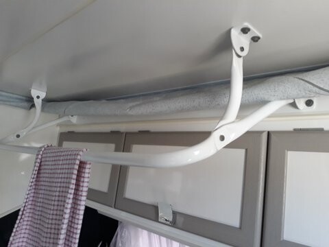

Linear actuators? Lots of choice of power and travel.
Also used for beds that are stored at the ceiling. youtu.be/L2EOrguTzZk Cheers, Peter

My thoughts were to buy a rotary close horse . Make a base plate for the floor and a top plate for the ceiling. set it up and wind up the handle .
yep ..getting the roof down is another problem and storing the "hills hoist " is another... plus the associated extra weight.

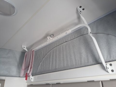

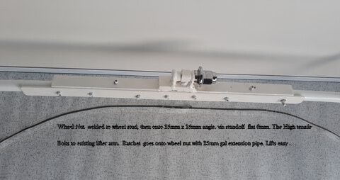

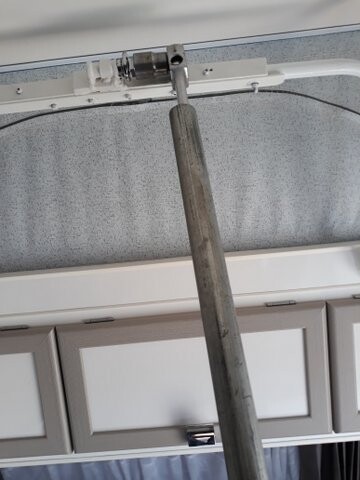

Finally made a solution, a bit more than oven mitts, but had it done before the post. ah well.
Obtain gold plated Toyota Mag wheel nut and stud, the some fiddly welds onto a piece of 8mm plate, to stand it off the 25mm angle, then bolt onto existing lift arm arrangement, use high tensile bolts as stainless ones bend.
Socket onto ratchet then a piece of pipe extension arm and slowly lift, one back off on ratchet needed. AND IT WORKS.
Craig..someone once said 'Necessity is the mother of invention', and I can see that you, like me would have probably have spent considerable time sitting at your caravan table staring up at the lifting bars.
Your idea certainly looks impressive...prior to me settling on the 'Chinese Oven Glove' I too came up with a similar idea to yours but found that the strain on the roof bar, with such a localised pressure point would probably eventually break the roof bar, the bar being small dimension RHS with thin walls with pressed, not extruded bends and mounts. (Mine is anyway). I could see mine breaking and punching a hole directly above the bed. (Happy wife, happy life!)
Your comment that the SS bolts bent would support my theory.
The roof lifting bars are so designed that the pressure is spread over quite a wide area, where the lifting bar support points meet the ceiling there will likely be a length of dressed pine 38 x 22 mm or similar behind the ceiling paneling, when used as designed the lifting 'pressure' is evenly taken up and carried across the width of that pine bar.
By lifting it and applying the full weight to the centre of the bar in a 'twisting motion' as per your design would, in my opinion, create undue stress on the bar.
Of course, as said this is only an opinion given I cannot see the actual set up.

Craig1 said
08:56 AM Oct 31, 2024
G'day Paul,
You may be right, only time will tell. But, that is why I used the angle over most of the bar to spread the load to where my arms reached anyway. Also, not clear on the photos is a piece of flat on the other side of original lift arm to stop bolts pulling back through. It is only about 1mm thick tube, maybe 1.2mm.
As I have the struts pumped to the max, it does not take much effort with my new arrangement. The other end is nearly a finger tip lift job.
