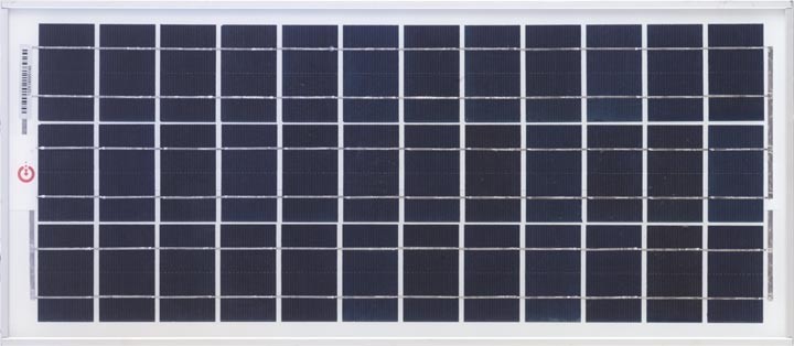

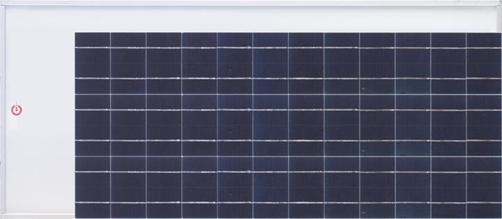

I think some of the problem is various companies give you efficiency for the actual cell, probably with no glass in front.
For my situation the actual cells use only 72.7% of the overall area of the panel. On this point alone there is a substantial drop in watts per square metre of the overall panel.
My comparison panel 200W size 1580 x 810 mm. Some offered were 1480 x 680, or 1476 x 670, some 300w panels 1330 x 990.
Looking at the 300w @ 1330 x 990 panel.
That's 300 / 1.3167 m² = 227w/m².
On a fabricated panel allowing for aluminium frame, cell spacing, glass, wiring resistance, controller inefficiency.
I will but polite, 227w/m² is BS!
