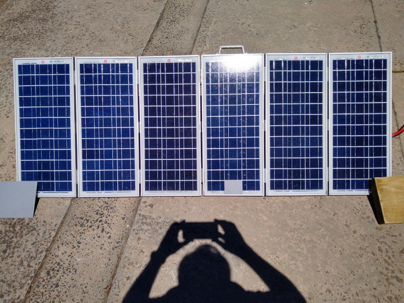

Have a look at the bottom of this page for my notes on shadows.
I don't have bypass or blocking diodes. There are 2 panels in series & 3 sets of them. A very small shadow will bring that set in series to its knees, so 1/3 of my 120 watts gone. A tiny shadow on each of 2 sets, 2/3 of 120 watts gone.
What was interesting on my setup was a shadow of each of the 3 sets, is I still had about 1/3 of the 120 watts.
If you can't move the panels you really have to think very carefully how you park so any vehicle self shadowing is minimised, as well as trees!

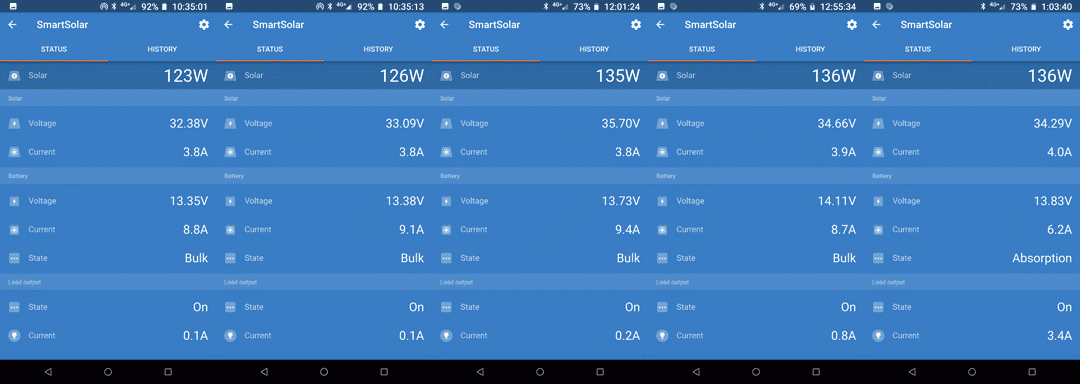

I have 2 & also had tested 3 panels in series. The MPPT controller will adjust the voltage output to what the battery needs. 2 panels in series is about 33 - 35 volts out of the panels. About 9amps from the MPPT into the batteries.

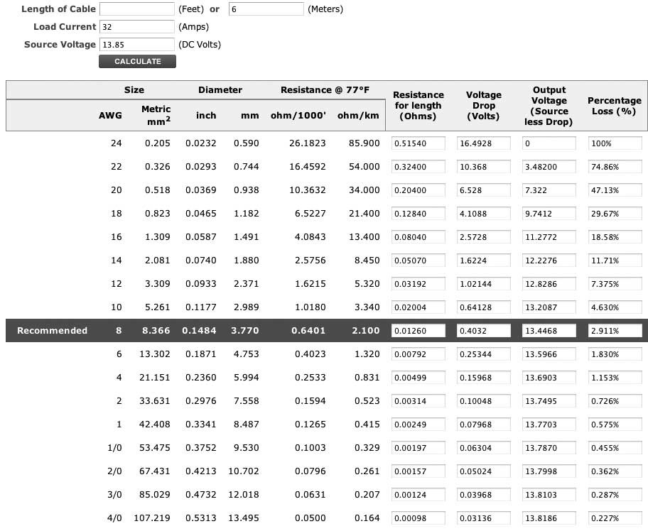

Running 6--8mmsq cable is more than enough in parallel roof mounted . Why because the cable runs are not that long
Series wiring has little benefit in a small van etc
01:08 PM Jul 23, 2020
For those who are not sure always calculate total length + & -

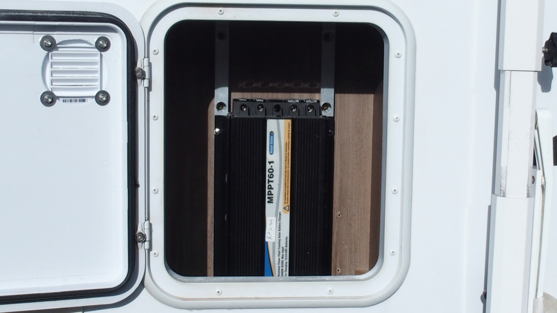

The regulator is a GSL MPPT60-1
Thanks Ian.
-- Edited by iana on Friday 24th of July 2020 07:08:29 AM
-- Edited by iana on Friday 24th of July 2020 09:19:16 AM
Whenarewethere, things could be made more efficient, however its not always practical or possible, I can for instance take off the panel that maybe subject to a bit of shade (I need to climb on the roof as see first), and use it as a portable. But that would be a nuisance, as I would have to reinstall it every time we moved. I don't think we do enough "Off the grid" camping to warrant any major mods such as being able to angle the roof panels, but that would help.
That regulator would be good. As I always say what does the battery manufacturer say for voltages, look on the side it is often shown there, but I would use the 14.5 setting and see what that does. Note a complete power down to change that.

What is the controller?
What are the loads on your system & can anything be done to make things more efficient.

Hi Ian
