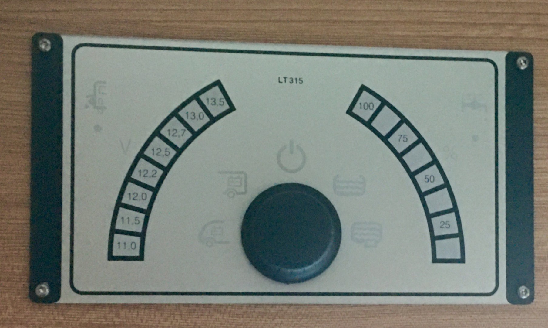

But what sort on meter do you have to monitor your useage and the battery condition. Important IMHO as it enables you to be confident of knowing what is going on. Not rocket science either but you need to learn what it does and what it is 'telling you'. Good luck. I have one of these
Mine is a dual one, does the MH battery too. But so easy to see the voltage my wife knows exactly whether it is charging or discharging or getting low etc. Not cheap but the second one I have bought now. You do need to learn what the voltage means though but you learn that as you go.
Jaahn
PS for the technical people those lights are not spaced equal voltage but matched to the capacity better, not like the cheap ebay indicators.
-- Edited by Jaahn on Monday 8th of June 2020 11:18:13 AM
-- Edited by Jaahn on Monday 8th of June 2020 11:19:54 AM
Davianni said
01:28 PM Jun 8, 2020
Thanks Jaahn, I do have control panel......instructions all in German! Looks pretty self explanatory though. As I cant hook up to 240 at home, looks like I must use gas and turn on the day before leaving. Think I better pick a site away from everyone then I dont look like too much of an idiot!

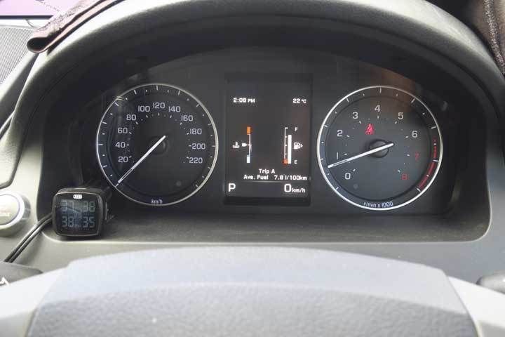

Going off on a tangent! It's worthwhile getting TPMS (tyre pressure monitoring system), it's better to catch a flat tyre before destroying it. It saved us 3 tyres in 2018.
& having a tyre repair kit & compressor (good quality) gives you more options & greater peace of mind, more so if remote.
Jaahn
Mine is only for 4 wheels as I don't tow.
