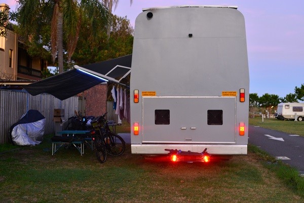

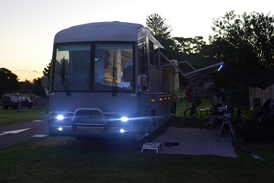

Great looking unit Stephen - that's a real home on the road.
Radar said
08:04 AM May 23, 2020
A bit flash.
Well done.

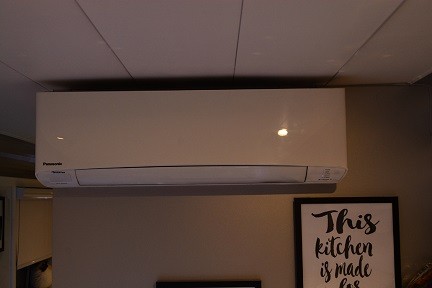

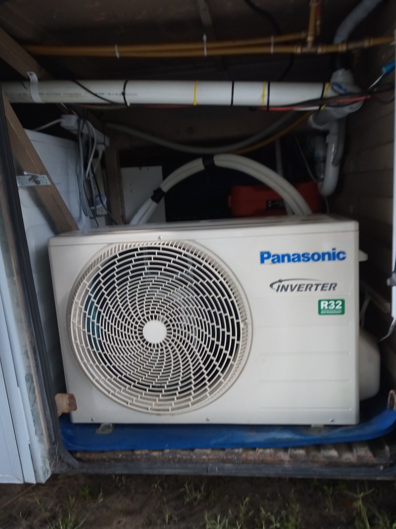

Where is the air conditioner condenser & if you are happy to elaborate, what is the solar & battery setup like to power the Life of Riley!

The aircon is a panasonic soft start with inverter
With 2.5KW Solar Panel setup
Battery's are from https://deref-mail.com/mail/client/IQ53XK-jvLM/dereferrer/?redirectUrl=http%3A%2F%2Fwww.felicitysolar.com
great company to deal with and in front off other's with their technology.!
Will run the hole motorhome for 2 day's flat out or 2 weeks with fridge and light's
The hot water supply is 10Lt with 2 stage auto power run's on 240v @ 1000W or 12v @ 800W
And the washing machine is a Beko soft start inverter.

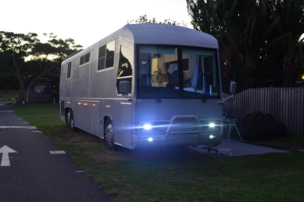

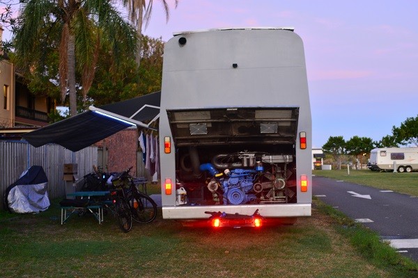

He's a tough little coach with a marine 430 MAN engine with a turbo!
With a fully rebuilt motor and a very strong 10 speed Eaton he goes everywhere.
With the comforts of home living { All full size appliances } makes travelling easy.
