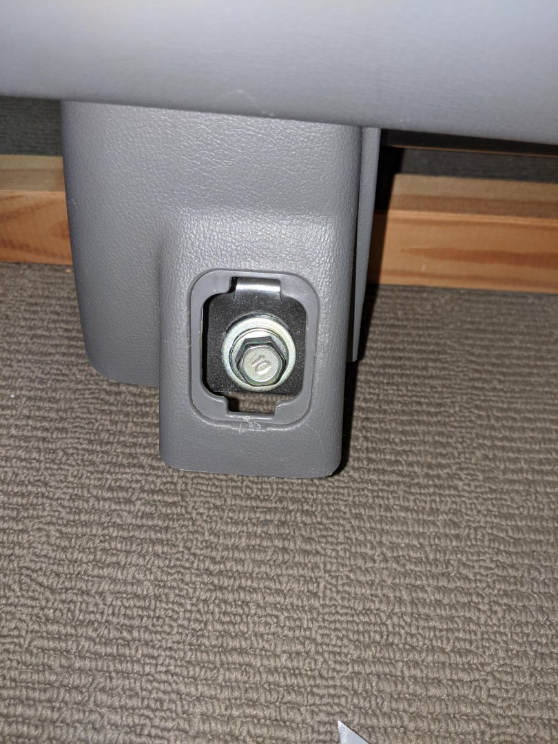

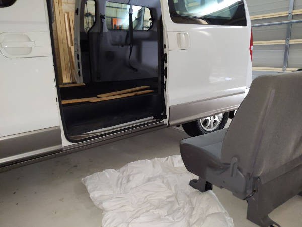

Ok I got the middle 2 seater off Heres the pics to show how

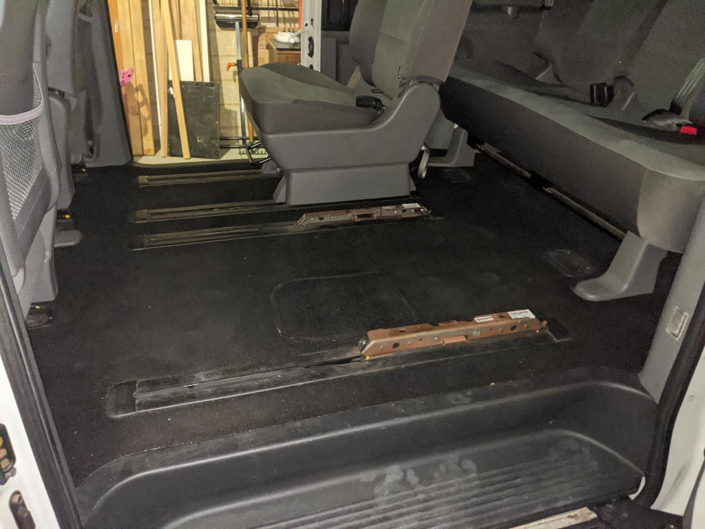

MungoTheB said
08:07 PM Mar 29, 2020

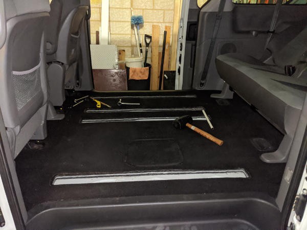

finally got the rail & sliders out
3 bolts holding the whole rail & sliders
even if you wanted to leave the rails in, you still have to remove the whole assembly as the caps are bolted in and have to be removed to get the sliders out.
once bolts removed
rail & sliders out

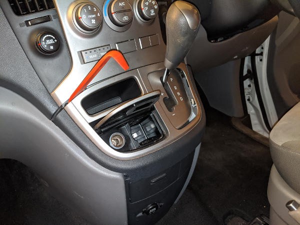

03:35 PM Apr 5, 2020

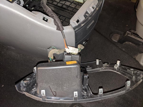

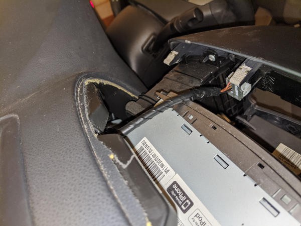

I HATE radio pins I got all BUT the card with the radio pin :(
need the last 4 digits of the serial
So time to pull the dash apart.
Showing the easiest spot to lever (apply a bit of presure to the phone holder gets you started
I forgot to take a pic of the top dash.
when you remove the bottom dash, there are 3 screws at the bottom. then the dash comes out easy enough (EXCEPT for the plugs, hard as hell to get out ESP, the clock one)
I got so fixated on getting the radio out, I missed the obvious (as in the past the serial was on the back)
0313 + 1212 = 1525 (here incase I lose my manual which now has the pin on it :)
Now have radio ya :) will check out if it was all worth it or later look at putting a new (touch screen,radio, bt system)

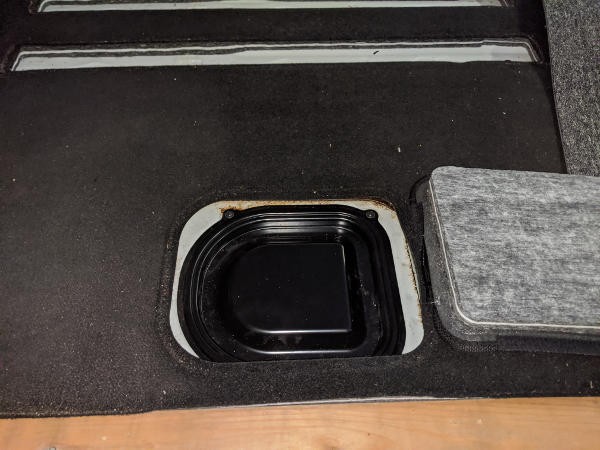

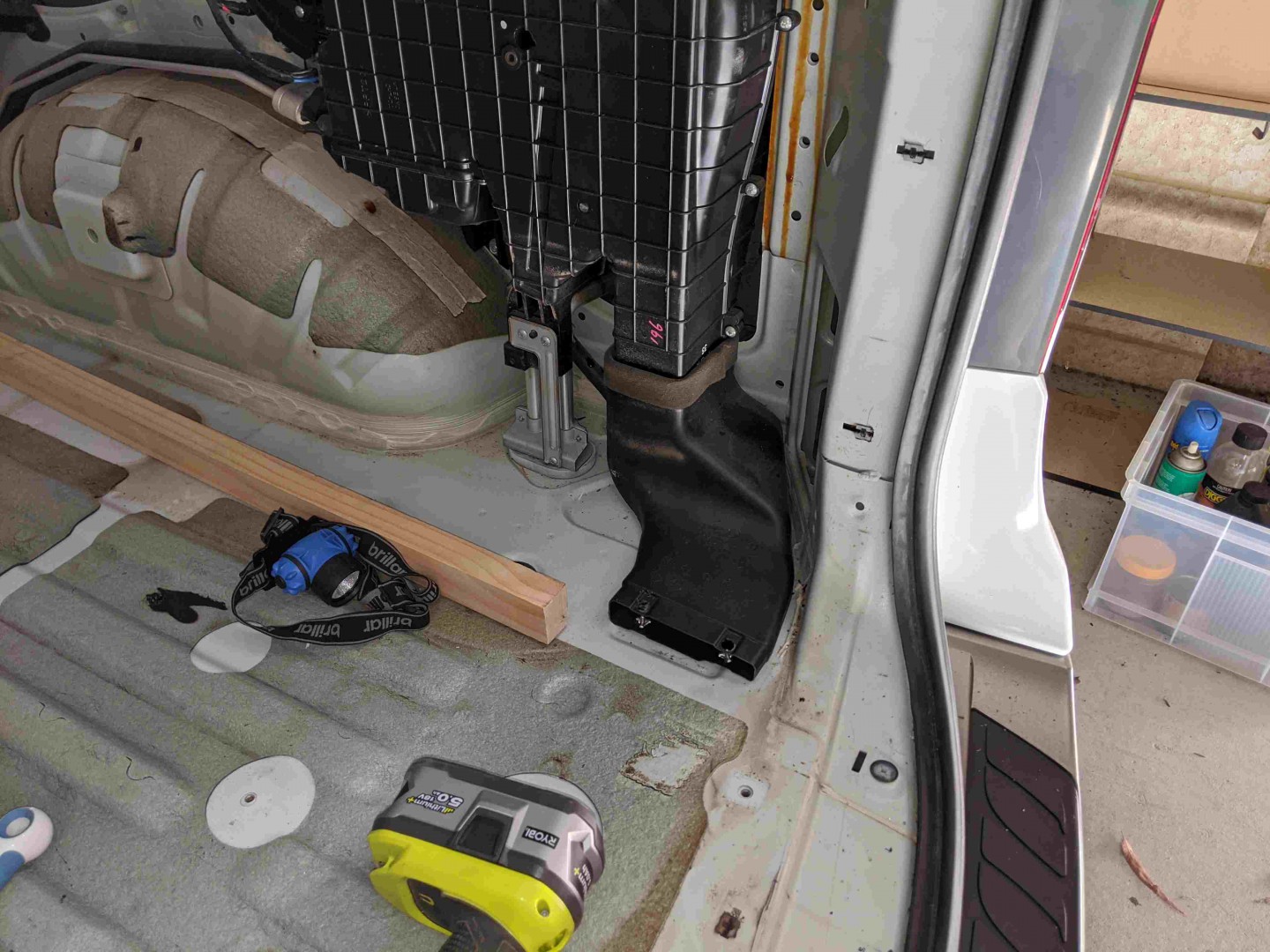

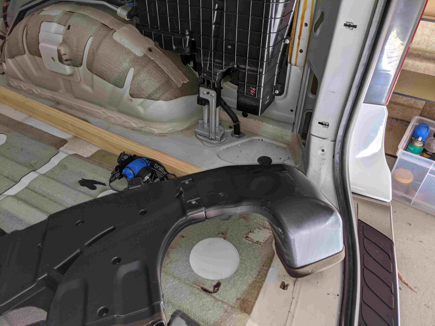

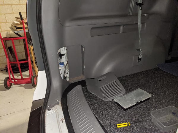

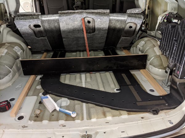

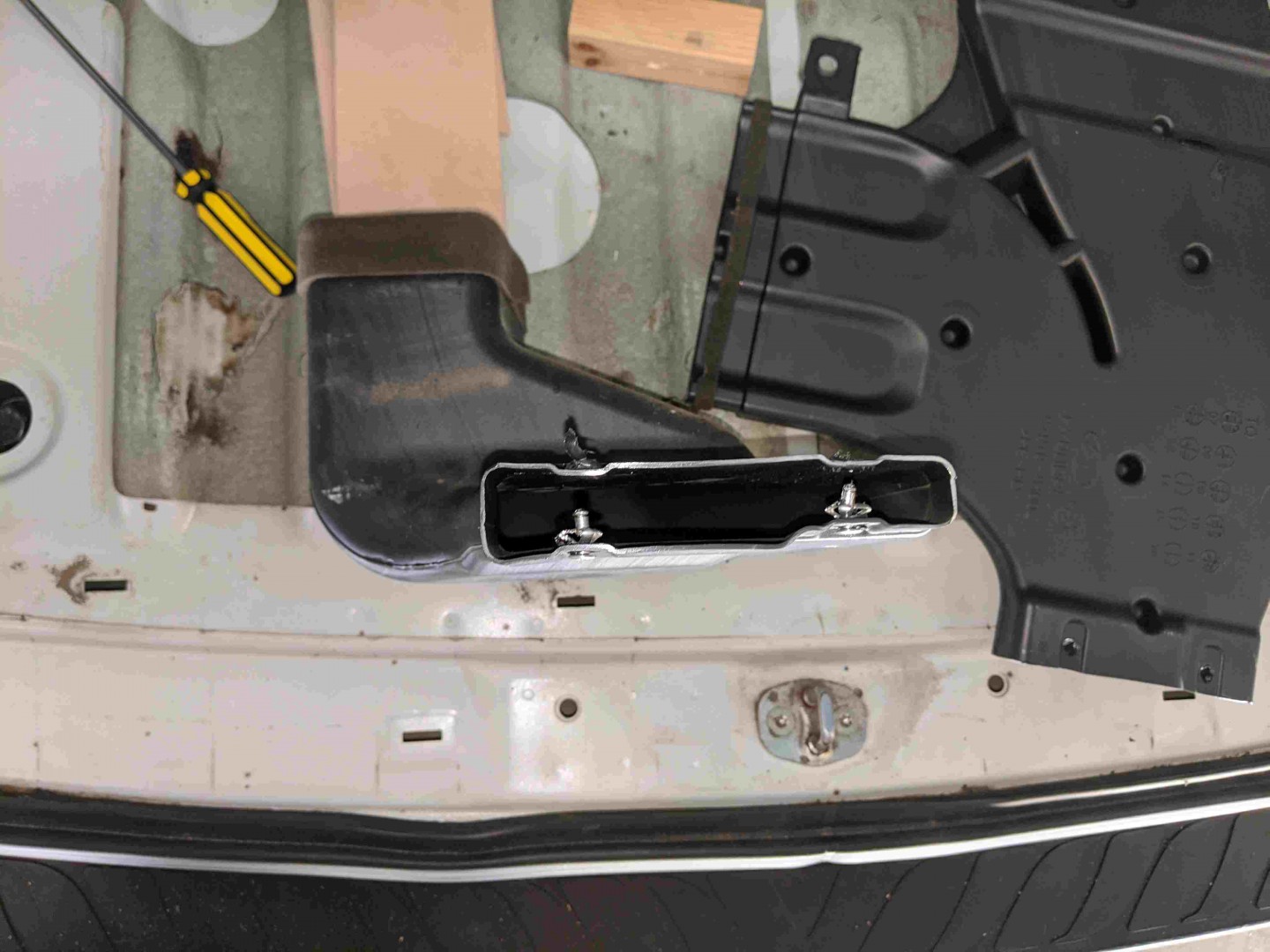

Time to think about the cargo area
does anyone know what this access (tried searching)
some have complete floors covering it,I would presume its needed to access something (can you tell I'm not a car person :)
And the main area
thats middle seat ventelation with the aircondition on the right side.
height 30mm clears it if I want to keep it (but cant see the point at the moment)
removing it will have the aircondition blowing straight down (maybe make a funnel to direct out back somehow.
anyone done any drilling into an imax or iload befor? :)

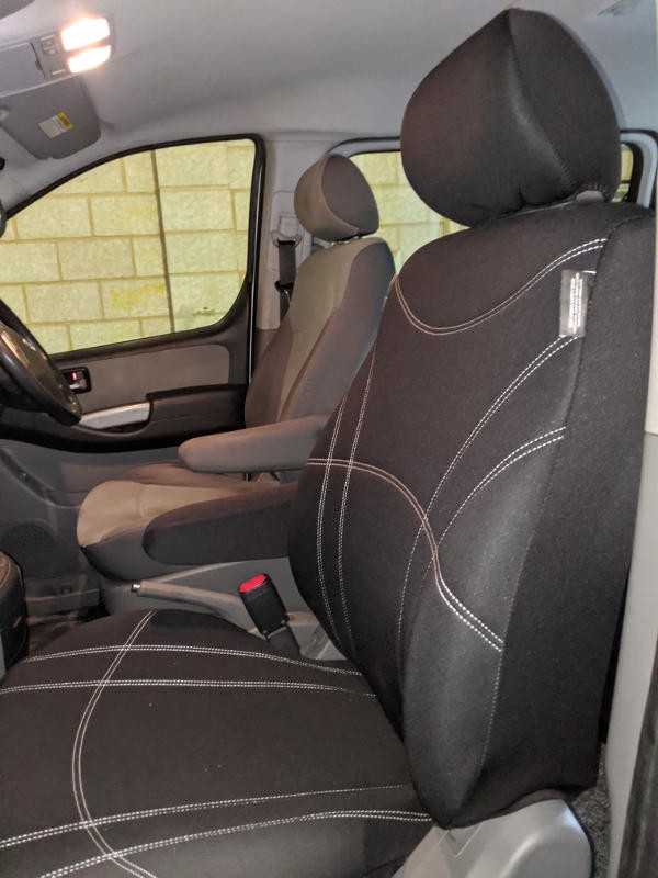

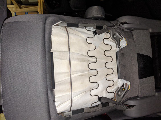

Then IMAX Seat covers
starting to feel as i'm the only one whos done anything to an IMAX interior :) finding any info is harddd :)

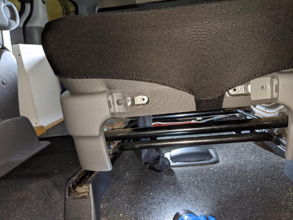

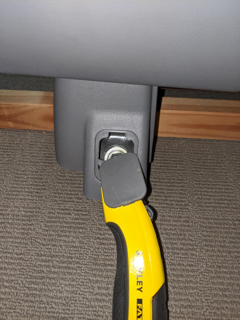

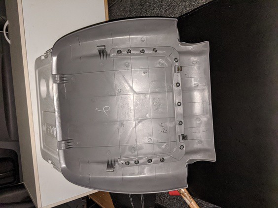

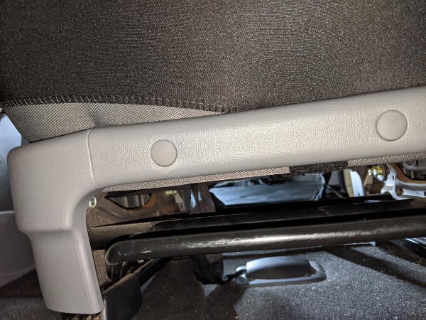

I didnt have to take off the seat back plate (but was good to find out how) 2 bottom clips are just pulled out, then push down from the top and pull out :)
But I had to take of the arm rest pop plastic cover, unbolt & remove
tying the seat covers was easy except the bottom of the seat
remove the front rail cover (just plastic plugs & screws
just pull lightly on the sides and it will let you slide the seat ties down the side instead of over the plastic
Try again :)

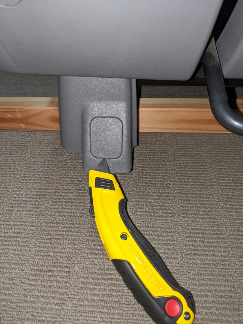

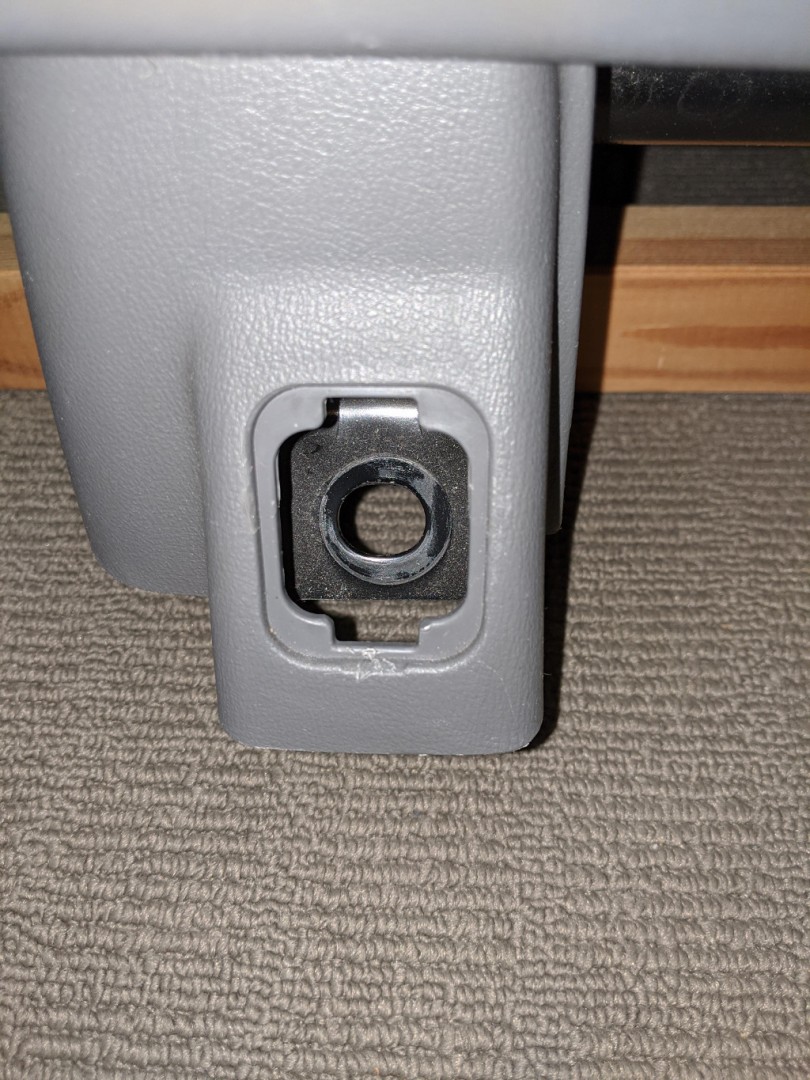

once bolts removed
rail & sliders out
-- Edited by MungoTheB on Sunday 29th of March 2020 09:24:00 PM

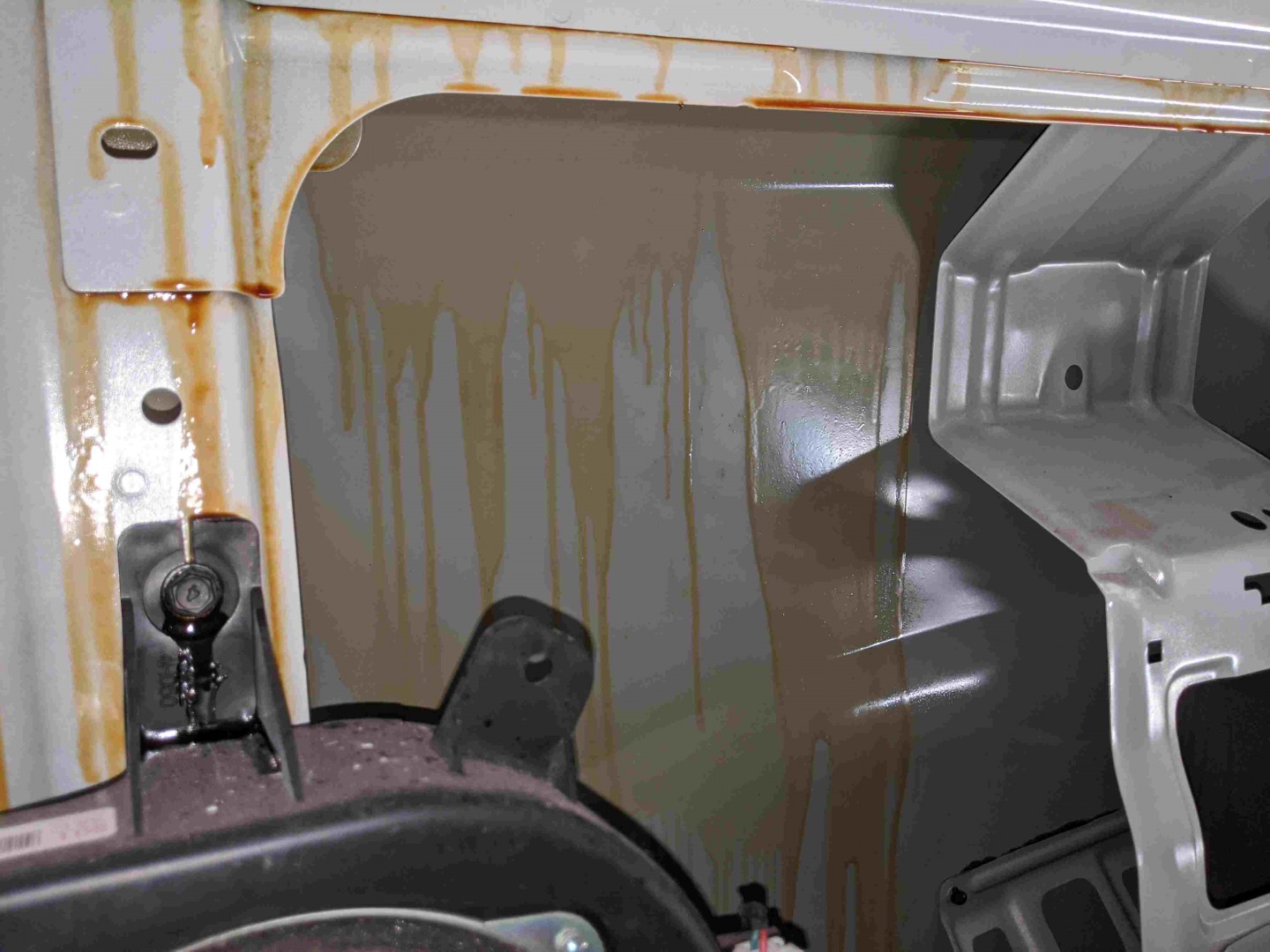

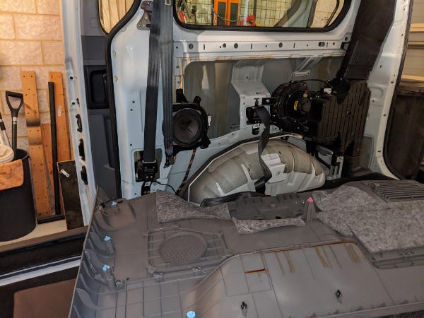

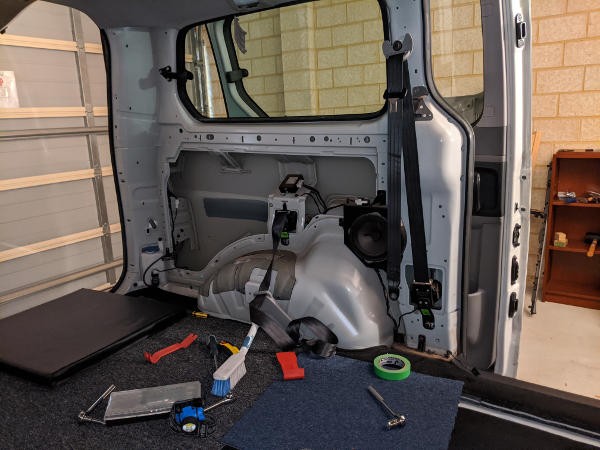

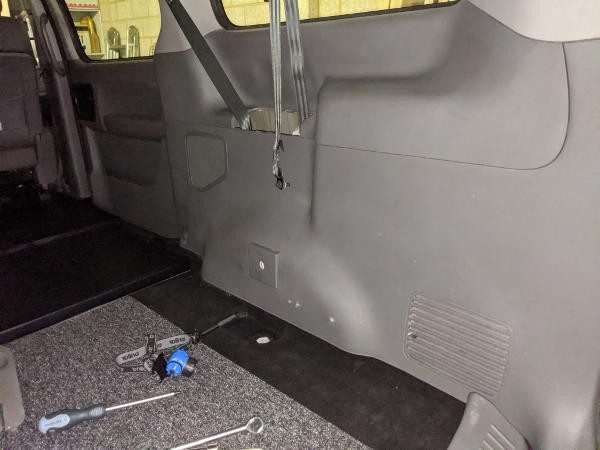

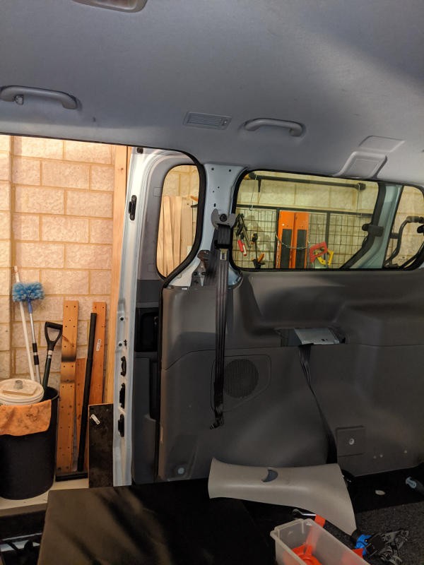

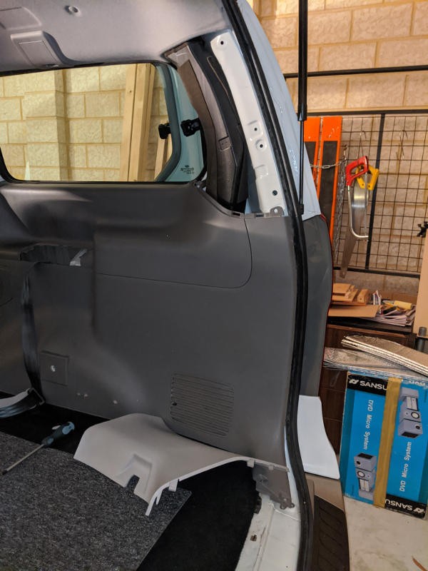

removing rear interior trim
undoing seat belts
Remove light grey moulding both sides
remove screws holding (easy visable) then pop with trim tool (only need one)
door step trim needs to be popped in corner to pull out side trim
remove bolts holding seat belts in
Done :)
And the main area
cheers
blaze
Removal of the vents are simple, just a few obvious bolts holding the plastic vents down
The difficult bit was the rivets holding the base to the vent (had to drill/pull them out)
put the base bit back for now

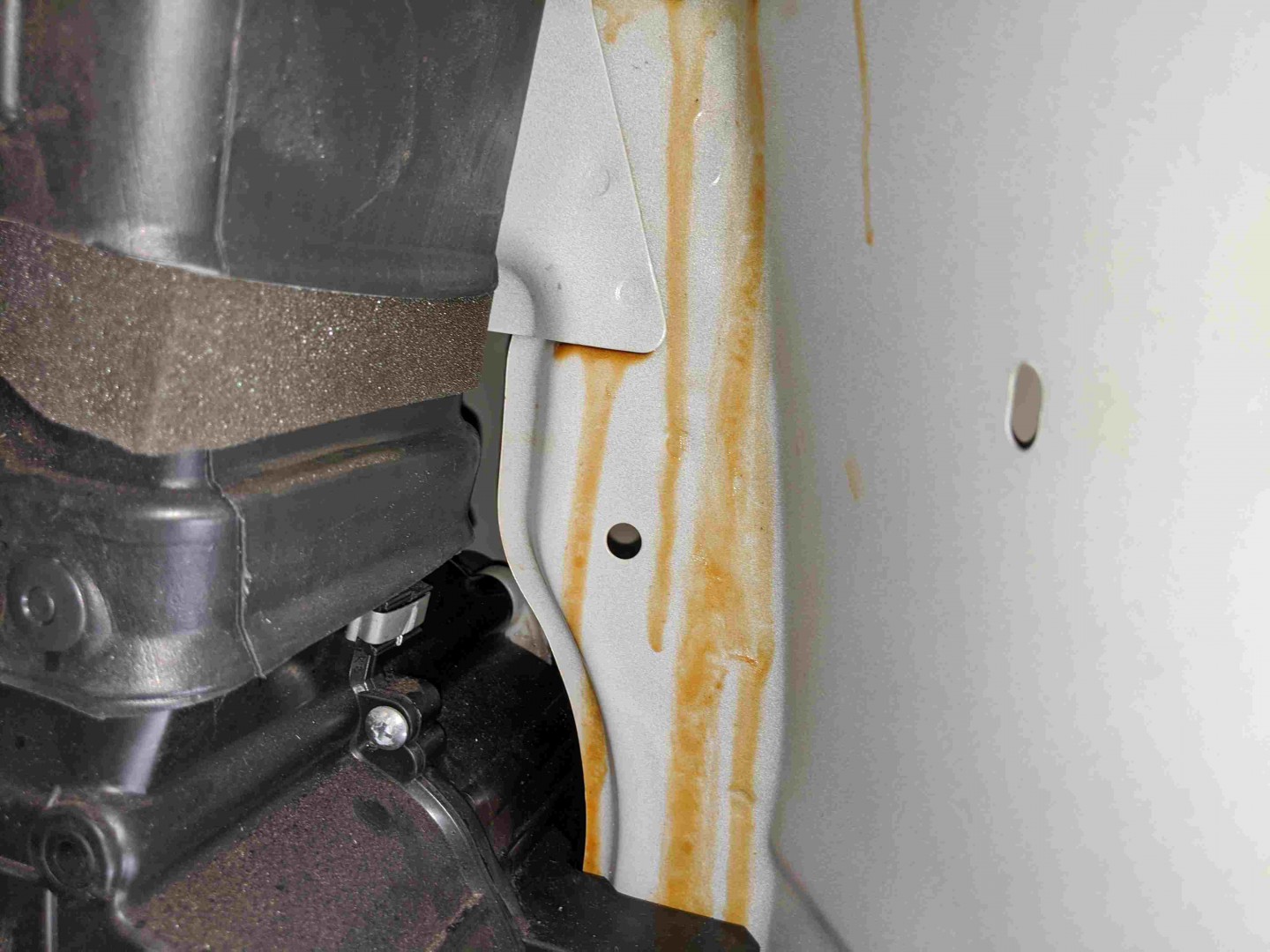

found all this yellow goop on the right side of the van, still sticky, not rust (havent found any rusting yet).
no yellow goop on the left side
any guess?
Looks like rust prevention treatment.

Well I stripped the back sections as you saw.
pulled out the seatbelts (wont be wanting them)
havent decided about the floor yet, but have filled the slots with wood & carpet for now and put the floor bolts back in (keep the holes sealed for now)
got side tracked for a while
had to make room for the imax :)
Then played with 3D

still deciding what I want to do in the back
But wanted at least the back portion of carpet & old sound deadening gone
Tried the heat method (exhausting, messy, took ages for one small section)
went & got dry ice (from https://www.dryicewa.com.au/ Myaree WA
did the rest of the van in less time that it took to do the smaller section via heat
just pour the ice, cover & wait until the popping & crackling settles down, then spatula the bits out
now to clean it up, might spray rust preventive over it and see how it cleans up
