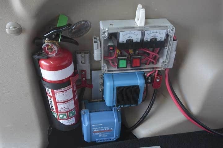

If you want everything in one box, buy or make or modify a box. Add some fastenings so it can be tied down. Stick a 120ah battery in it & fasten it down, & a good quality MPPT controller, best place for it is next to the battery, not on the solar panel. DC-DC charger would be ideal to charge from the car but not critical, have some spare room in the box to add one later.
Buy from Jaycar 12v & 5v outlets, fuses, better still circuit breakers & Anderson plugs for solar input. Stick a voltage meter on the outside of the box. A quick calculation of voltage tells you how much you have left. After a few weeks you get very good at guessing what's left so you really don't need it calculated for you.

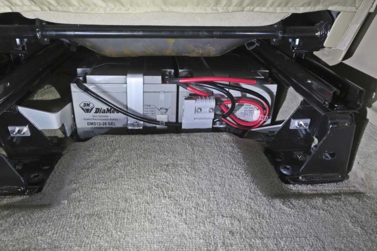

Solar panel plugged into the Anderson plug on the left side of the meter box. MPPT under meter box, DC-DC x 2 at bottom.

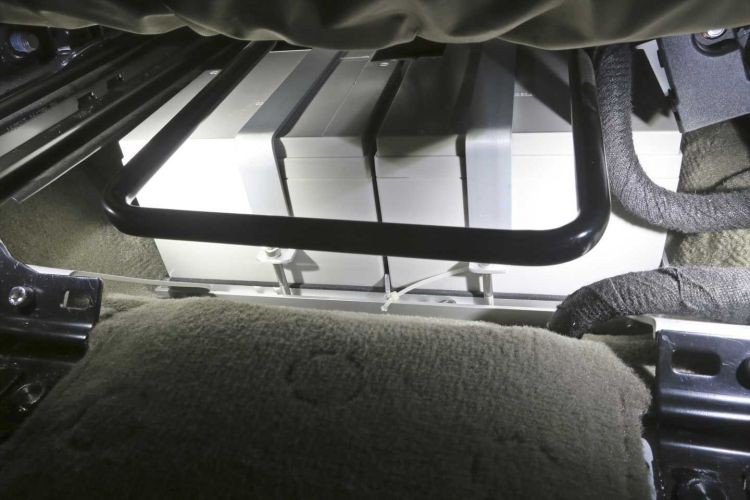

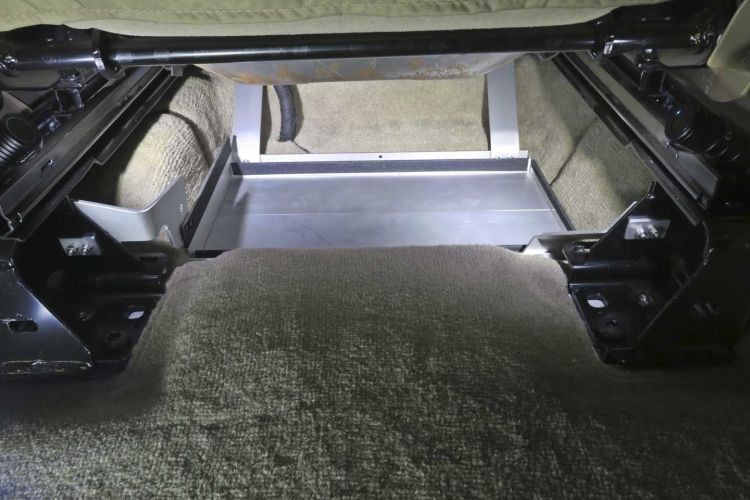

Two of my batteries under a seat.
As we sleep in the car it was better to have components spread around the car. But all these would otherwise be in one box.

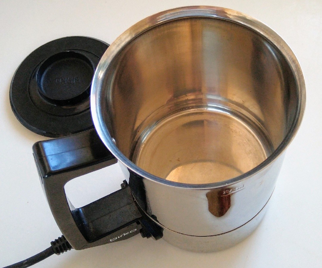

The Birko kettle is 750 watts so a lower load on your batteries, but obviously longer which is better.
No plastic inside & really solid stainless. Only disadvantage is it is plugged in & needs to be switched off at the wall or plug pulled out.

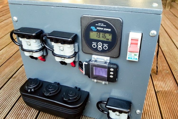

A DIY 100ah lithium box:
