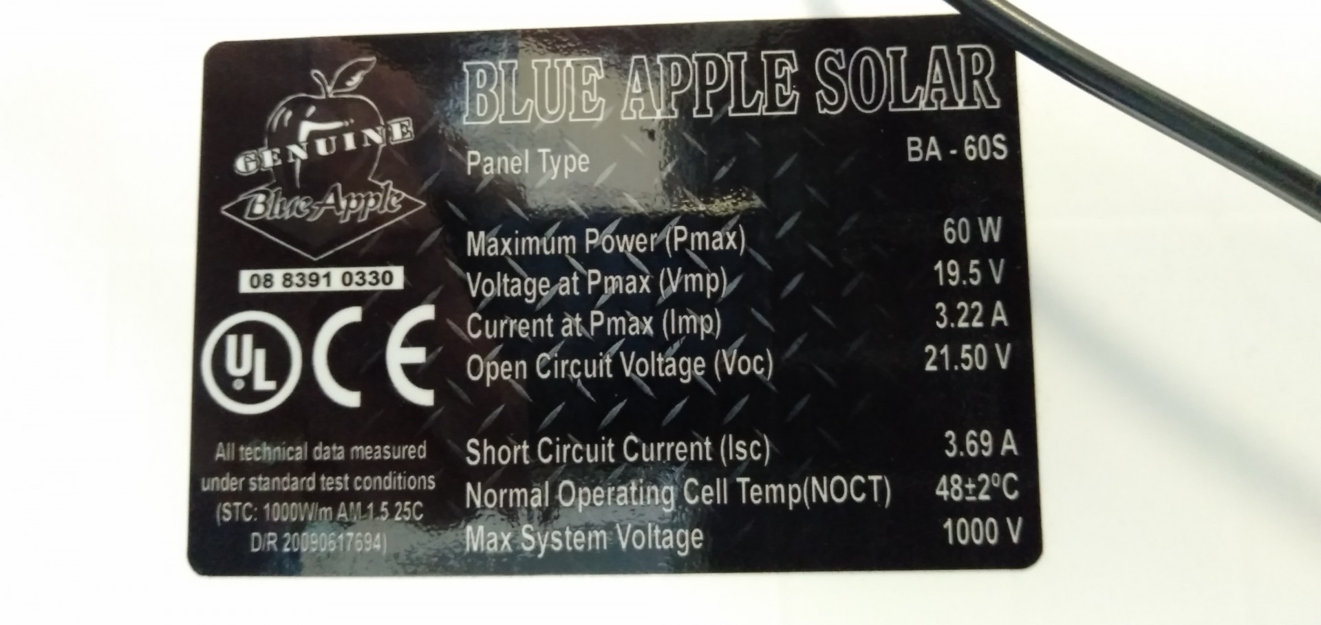

No, they do not have "their own manufactured" solar panels. At best, they put their own label onto what they buy from somewhere else.
Ask to see the original manufacturer's label from the back of the panels. It would have had one when they purchased it. With that information, you can check the validity.
If they have removed it or won't show you, move on.

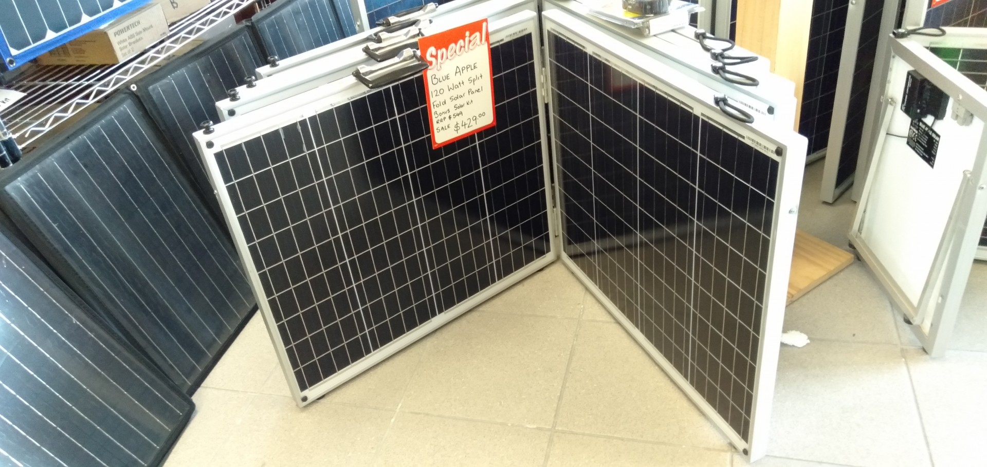

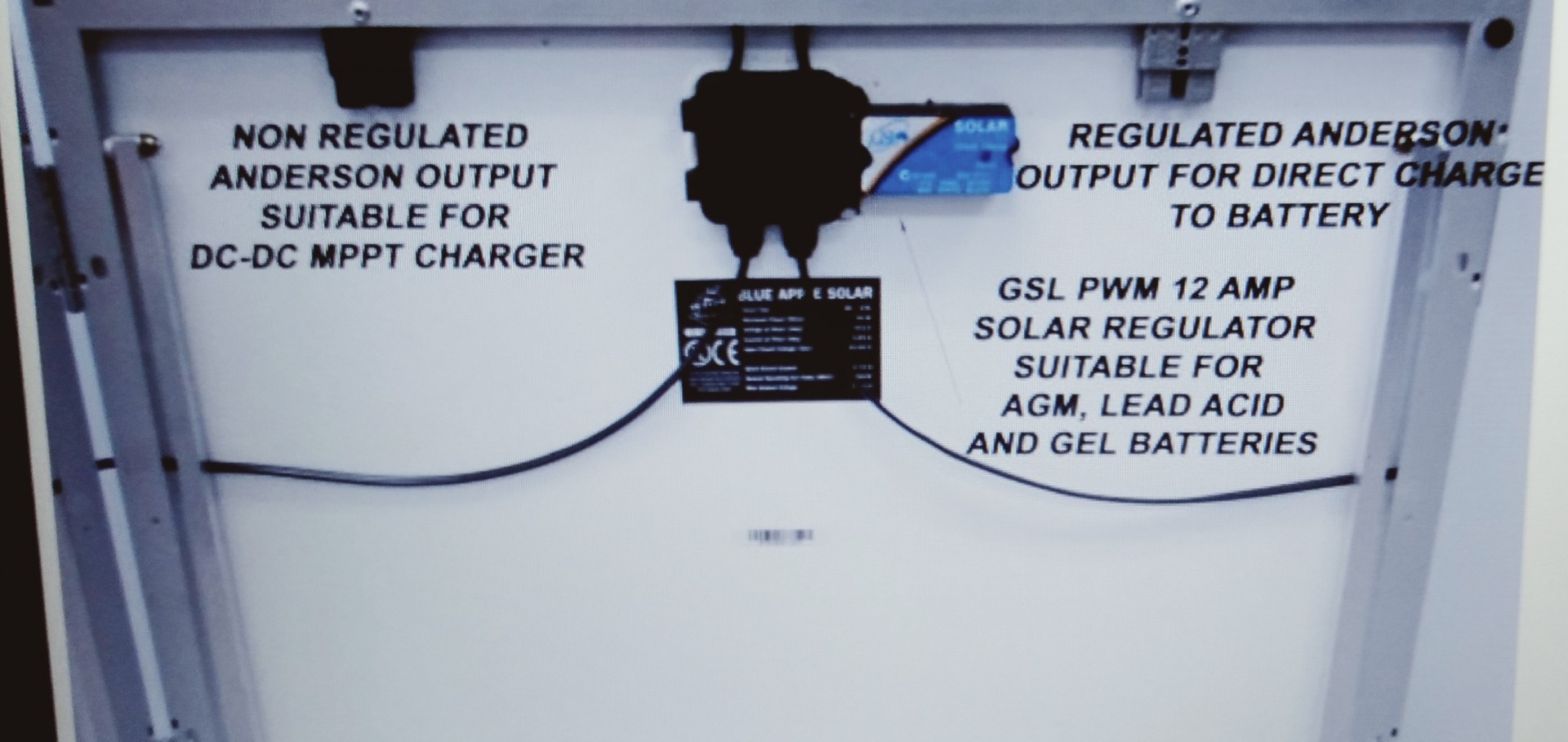

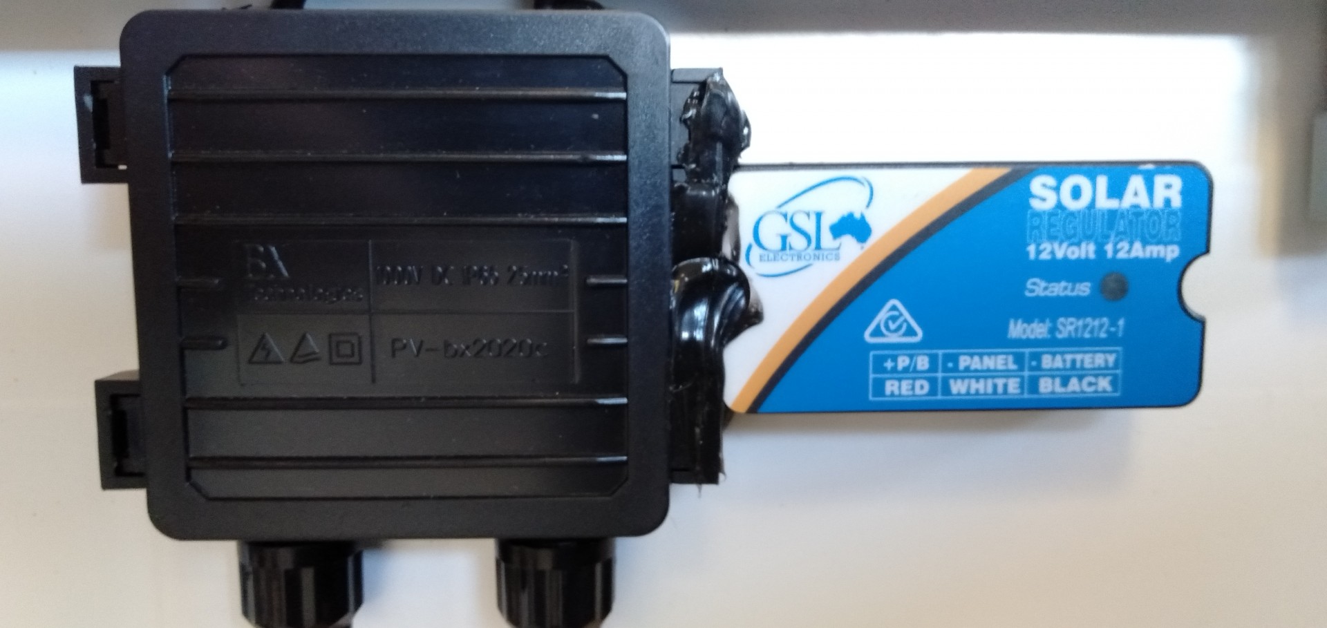

hi , thanks for your input , i spoke to the "Home of 12Volt" that sells the "Blue Apple" solar systems , they are Chinese panels made by robots and the "Home of 12 Volt" factory build the frames and fit all the electrics to the panels , all parts are water proof , 10 year structural warranty and 25 year performance warranty I loaded some pics , they appear to be one of the better built setups available in SA , and they also sell roof top setups , and can arrange installation , we are still deciding on camper roof solar system or portable folding panels , sometimes we will be taking our boat only , with car fridge and awning / tent , and other times camper and kayak , thanks john
thanks for your prompt reply , great advice , I am all ears at the moment , all the people I know with caravans all have at least one solar panel on the roof , no portable panels , and the other people with "Cub Camper" types have generators or the very cheap folding panels , so I have to decide whats going to suit , especially if we go off camping and take our boat and use our car awning and tent , and the other times when we take the camper and a kayak , maybe I need to look at getting both setups , if my "financial adviser/supplier " will agree , cheers john
JaCaDaK said
05:37 PM Jan 30, 2020
thanks Bobdown , I will speak to Goldstream Caravans service and ask whats the max weight and best roof location on our windup Crown , it already has a Fiamma wind out awning on one side , and then speak to my "financial adviser/supplier" about getting both setups , folding panels would be handy when we go camping with just the boat and awning /tent , cheers john

The price of that panel in your pics seems unusually high, have a look at Kings panels from the 4WD Supacentre or search around, you can get similar panels cheaper.
The cheapest part of the whole exercise is the solar panels.
It's the wiring, controller, plugs & maybe labour costs, which are by far the most expensive part. So put the research in so the job is done once only!

The down side is first the cost of most bought sets. Waay to much for a very ordinary bit of kit. I made up a couple of portable panels out of normal panels off ebay and did the wiring and stuff myself, for a third that price. Having the regulator on the panels is the worst place for it. It should be near the battery to work well and it should be at least a three stage regulator, preferably adjustable voltages to get max life out of your battery. Next thing is the weight of folding set to handle. I did disconnected mine and used plugs and sockets to make handling easier. But I am older !

But to sum-up. Portable panels have a use and can be good if you want to chase the sun for max power, particularly if parked under a tree for shade. I have used them in the past. But they are heavy and you need to get them out and also store them when travelling. Security also may be a worry.
