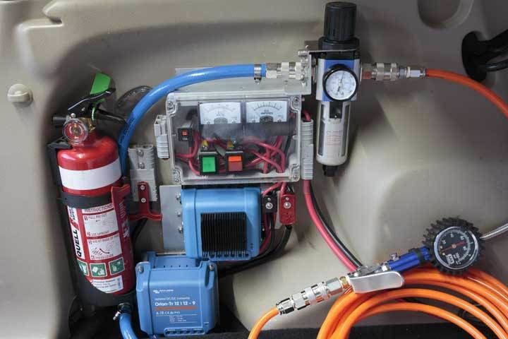

No offence taken. I should, however, clarify my "200W" figure.
When I got the blanket, after waiting for a clear sunny day, I just put the panels flat on the ground I was getting around 210 to 220W. Once the blanket got hot it dropped to about 200W.
After I messed about almost endlessly getting the blanket at a good angle the best I managed was 252W but, again, once they got hot the output degenerated to about 230W.
I would surmise that their 250W figure is pretty accurate under controlled and ideal test conditions and for them to advertise the blanket as 250W is fair. I think you'll find that most solar panel makers advertise the panel output as what can be attained under controlled and ideal test conditions. There is a standardised set of test conditions that they mostly use.
My folding panels were advertised as 100W and are flat out making 75W under real world conditions and they came from a source that has a very good reputation and they cost a heap. Under clear, cool and sunny conditions with the panels pointed at the sun they can make a bit more than the claimed 100W.
In the real world when the blanket is just spread on the ground or propped up on the car windscreen at a less than ideal angle I get around 200 to 210W which I reckon is reasonable.
And when they were spread out in the back yard on the grass they got hot enought to kill the grass under them. And yes, I DID get into a bit of strife for that...
Here is how they are generally laid out when we're away. The folding panels are charging the second battery in the car which is our emergency stash of electricity.

Yep - I've still got it and I use it only as an emergency spare in case the Victron goes belly up. It's in the shed "somewhere". It's a simple PWM thing with no settable parameters and which generates considerable RF interference - no AM radio while it's going. I reckon it's only advantage is the "cheap" aspect.
It's worth noting that a relative got a similar regulator with a set of folding panels. In with the panels there was a hand scrawled note saying the regulator is useless and to get something decent, which of course they sold. I've had a past association with Victron so I got him a MPPT regulator for a keen price.
& buy a couple of panel meters while at it, amps & volts, you will know what's going on all the time!
