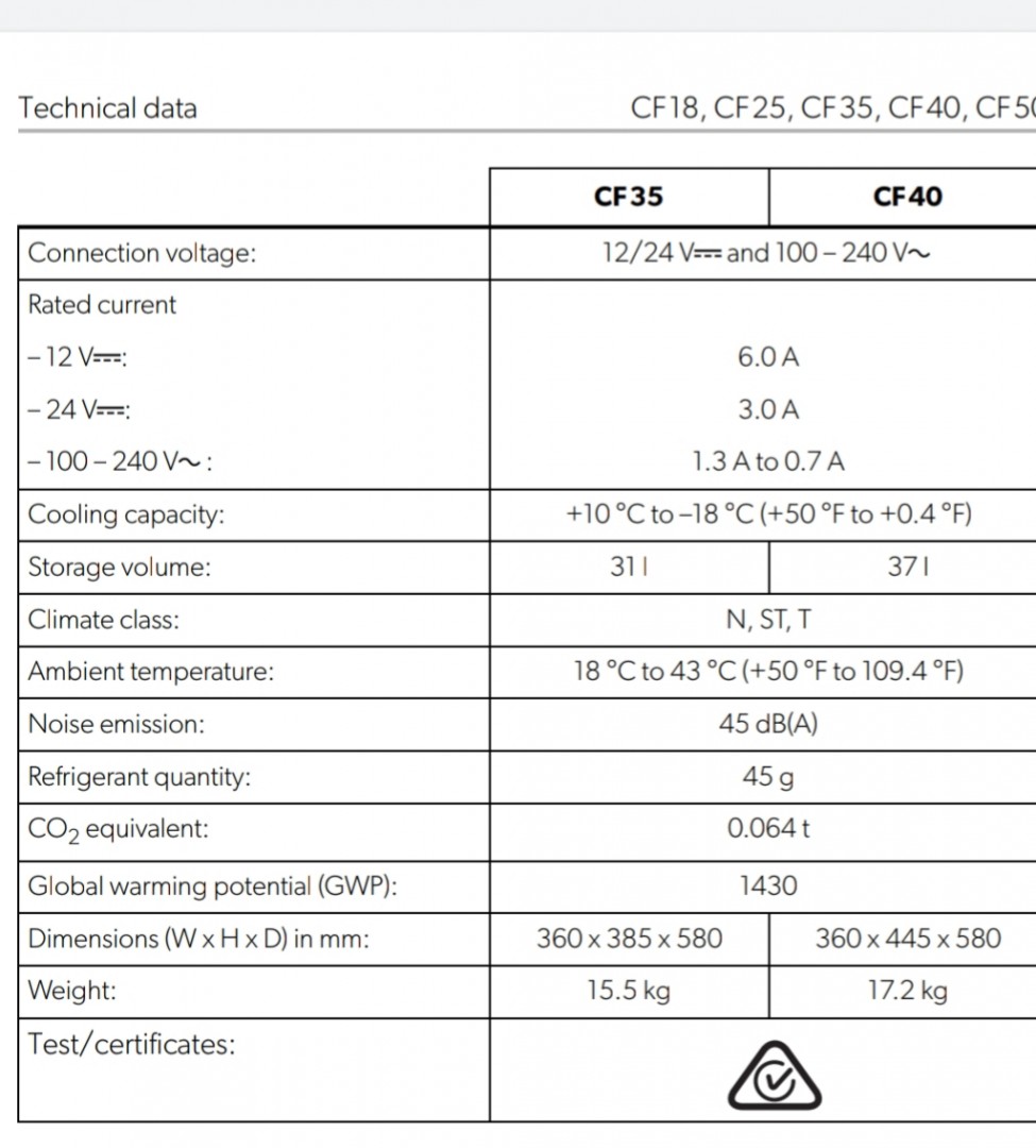

I have a dometic CF40 fridge i use camping. Have used it a few times and the ute battery struggles after 2 days. So i bought a 40 watt solar panel to plug unto the anderson plug. The panel in theory should provide about 2 amps. The fridge pulls 6 amps when running.
I know there are a lot of variables but is the panel likely to help much? Will move it 3 or 4 times a day. What can i expect?

That appears to be a very power hungry fridge! May be worth adding some good quality insulation around the sides, base and top.

Your CF40 uses basically the same power as my CF28
