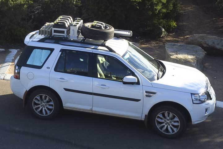

142kg on my roof including roof rack. I remove fuel, 50L max, asap & put solar panels, 15.3kg (120 watts), in the car for corrugated roads. I have worked seriously hard to reduce weight as much as possible replacing a roof platform with a second pair of cross bars, net saving 16.4kg. Spare wheel tie down crossbar has been drilled to reduce weight.
My mantra, "jerry cans are for emergencies not to save a few bucks". The decision to go Lithium is yours. It's a lot extra to outlay unless you need to save weight or you want a decade plus before

T1 Terry
Much too much weight up there.
Why all the fuel? And leave the genny at home.
I much prefer set and forget for the solar panels. Fit as many as you can.
