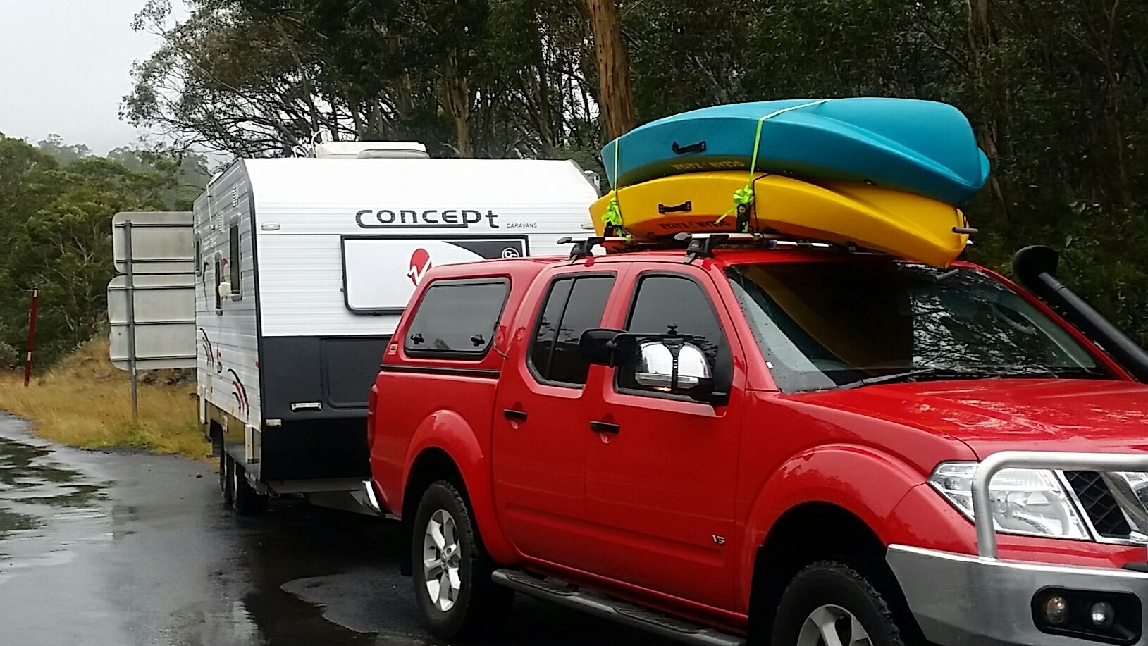

Hi Kaid
Earier this year I purchased 2 wide plastic moulded kayaks that stacked inside each other upside down for transportion, sounds good.
I placed the roof racks on car as wide apart as I could get them on our dual cab ute, next the kayaks, 2 straps to finish off. Headed down the road, slippery things moved about a bit because the racks are not far enough apart.
Now as I have a canopy I was able to add another bar onto to the top of that which gave me a better spread for the transport of the kayaks.
Now have solved that problem for a while by giving them to the Grand kids so I can go buy a better narrow, a bit longer, not much longer kayak and then I will start all over again learning the best way to transport the new one.
Ps, it is very peaceful out on the water paddling along.

Valkie said
06:33 PM Oct 12, 2019
Radar wrote:
Kaid wrote:
Hi All,
hope I have put this query in the right place.
I want to get roof racks on my car to carry a Kayak.
My question is
Do we need to use Kayak holders or not?
Bit paranoid about safety aspect .
Happy to receive any help
Kaid
Hi Kaid
-- Edited by Radar on Friday 11th of October 2019 05:51:21 PM
Thats exactly how I mount my two kayaks on my vehicle.
First it was the old Xtrail, drove from Sydney to Qld with them mounted this way, the only padding I do is some of those plastic floating tubes you get between them
Now I have a MU-X, same way, but I needed a small step ladder to get them both up there.
Get some of those straps that have a friction lock and you will never have an issue.
PS I drive at 115 plus all the time, never an issue.

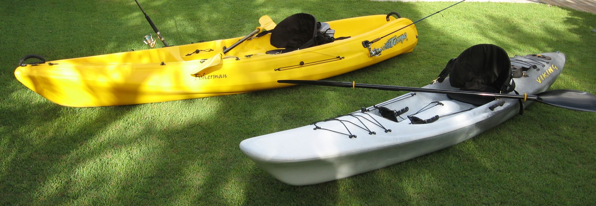

I have just got the news that I have just inherited from a friend, the first kayak that I ever paddled. It will go straight to my grandson who is keen to go kayak fishing with his mates (he lives on Moreton Bay). It's just a boring blue, not like your stand out SOT. It looks a bit like the attached blue one.
Mine are the conservative yellow fisherman & the grey exercise one that I got as a 70th birthday present.
If you have a problem with the tie down strap webbing resonating in the wind put half a twist in the webbing.
With my Sit On Top kayaks, the manufacturer recommends that you transport them upside down to prevent distortion of the hull. ie. without kayak cradles.
This is what I do with my two Viking SOTS. If I had F'glass/composite SinKs (I can only dream) I would use cradles.
I slide my kayaks over the bull bar onto the racks with an old sheep's wool mattress cover protecting the roof of the Patrol & a sleeping bag over the bull-bar & bonnet.
I have put hard plastic tubing covered foam (from Clark Rubber) over the roof bars, after wearing out lots of pool noodles.
To secure them, I use 2 kayak cam buckle tie downs from Anaconda around each of the kayaks onto the roof bars. Do not use ratchet straps least you over tighten them & distort the hull.
Then I put an extra strap right over the kayaks & through the rear door openings of the Patrol. Thus the whole arrangement is not dependent on the gutter fittings of the Patrol.
All straps are twisted to stop them howling in the wind.
The tie down is completed with front & rear ropes using truckie's knots from each kayak onto the bull-bar & the rear recovery fitting of the Patrol.
They ain't goin' nowhere!

Hi Radar ..
This may not be the one for you as it is 19kg, only 1 Kg lighter than yours.
It is a great exercise kayak/Ski L 4M, Width 62cm, Wgt 19 Kg carry cap 110 Kg Price new circa $1099.
Here is the Viking Website. It shows the Javlin but if you look around the site you may find a lighter one.
https://www.vikingkayak.com.au/shop/kayaks/javlin+14+all+round+ski
If you want lighter than the Javlin, you'll probably have to go to a fibre/composite SinK. Big $s for a good one. One of those Kayak Wharehouses may be able to help.
I personally wouldn't consider anything shorter than 4M (for tracking & ease of paddling). The only plastic ones lighter than say 19Kg, would be the little stubbies that are very popular with first timers & families splashing around on a dam and do a good job for what they are. If you are going to do any touring or paddling in open water you will really need/enjoy a longer one.
I'll duck now as I get a lot of incoming from all the owners of stubby SOTs including a few Hobies.
