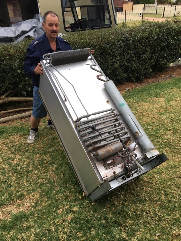

Went through same thing . Even fitted two fans and opened up venting . Ended up fitting 12/ 240v compressor fridge / freezer . Heaps better . Added extra two solar panels to be sure . Much better temp control. In my case .Try 1 or 2 fans to push are through heat exchanger?

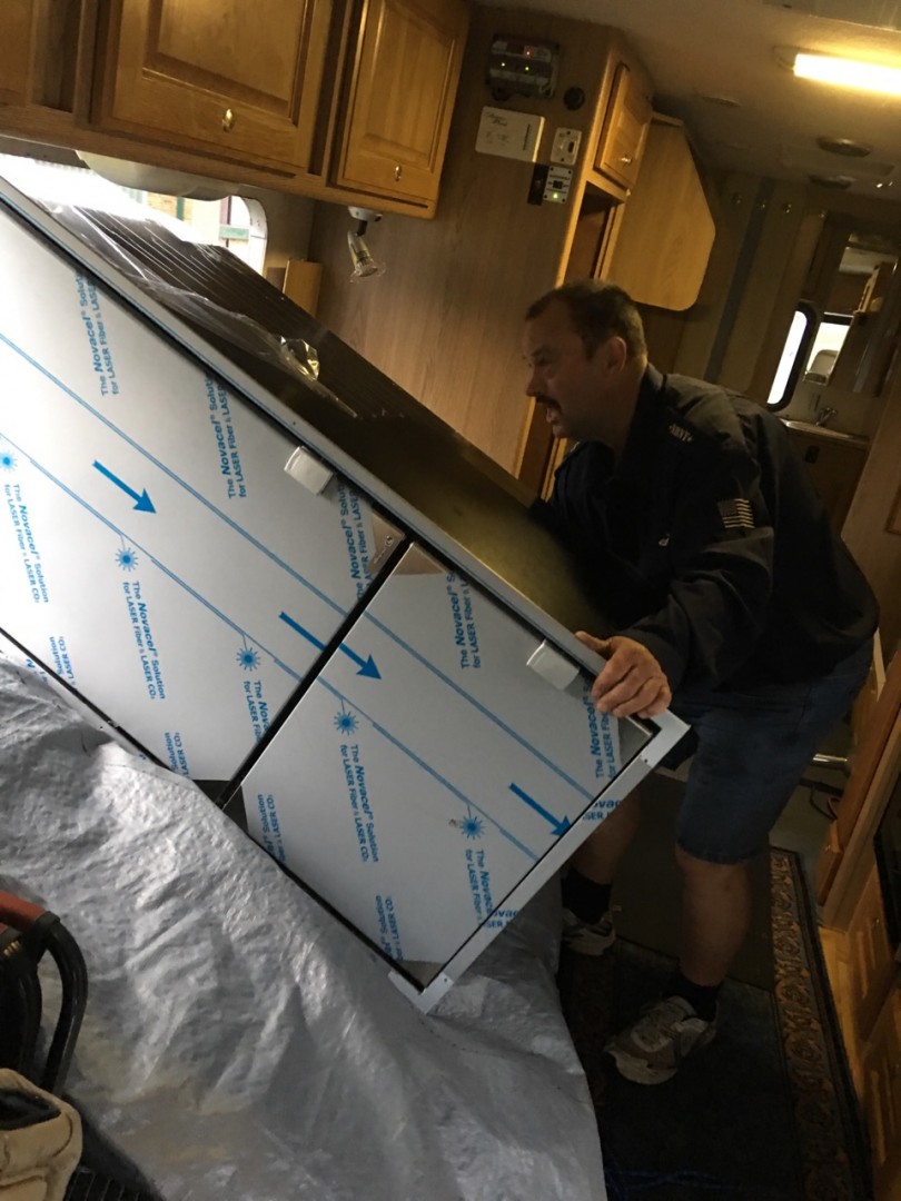

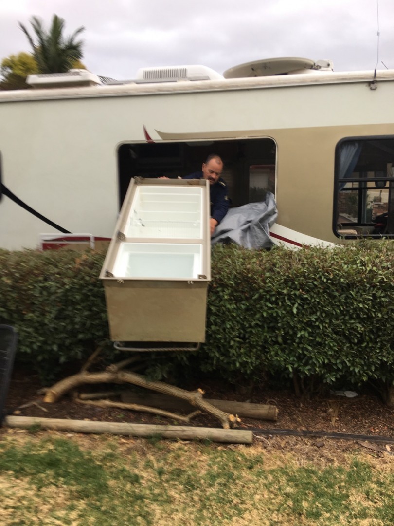

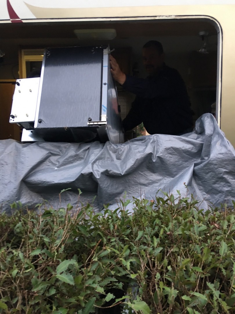

Did the changeover myself . Through side window . Not the big job it looks . Rigging etc is my game, helped big time . Wall and hedge helped .
