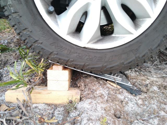

I was in the aluminium industry for almost two decades and sold hundreds of tonnes of treadplate. Aluminium treadplate should be left unpainted as the main purpose of the produced is tread plate, ie to be scratched and marked. I use a couple of pieces as jacking plate/leveling ramp.
