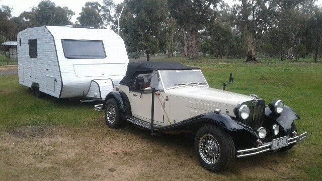

The little car in my Avatar is one that I built and I belong to a car club specializing in home built vehicles or ICV's as they are known. Some of the superb builds that I have seen over the years are just amazing. I note that Eaglemax has an ICV in the JBA Falcon as well as his home built van so doubly amazing bloke. Well done.
So if you want to build your own, I say have a crack. The sense of satisfaction at the end of the process is really something that never leaves you.
