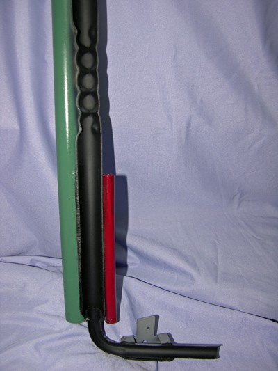

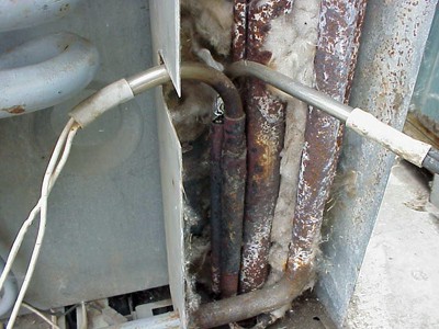

There's no technical reason that a 3-way fridge shouldn't work equally well on 12V DC as 240V AC. The principle of operation is a simple resistive electric heating element attached to the side of the boiler heating up the ammonia solution inside. In the pic on the left you can see the 'L' shaped AC and DC heating elements slotted into tubes welded onto the side of the boiler. The coloured cutaway makes it easier to see - the black is the boiler, the green the gas flue, and the red the pipe the electric element slots into. In the case of a dual voltage fridge there would be two of the red pipes, one for the DC element, and another for the AC element.
So, it shouldn't matter if it's a DC or AC element, if they are the same wattage they should put out the same amount of heat, and heat the boiler equally well, and therefore cool the fridge equally well (all other variables like ambient temp, rear ventilation etc. being the same). And that's why the manufacturers specs claim the fridge will meet test conditions equally well on DC as AC and gas, but we all know from experience that in reality our fridges rarely cool effectively on DC. So why?
It's because a number of things conspire to make sure the DC element never gets to it's intended output, and so does not perform as designed. The main culprit is voltage drop on the supplying wires. There's a long way from the car alternator/battery to the fridge in our vans, and most cars and vans are delivered with woefully undersized wiring. Then we try and push 15-25Amps through that wire for today's large 3-way fridges. Voltage drop is proportional to current and length of run, and inversely proportional to size of wire. Result is the heating element is running well below it's rated wattage because it only gets 10 volts or so and the current can't increase to compensate because it just gets burnt off as heat in the undersized wires. So, the fridge running on DC barely maintains the temperature it started at.
It's not a problem on AC as the wire runs are shorter and the current is a fraction what it is on DC, so voltage drop is negligible and the AC element can happily run at full rated wattage.
The solution is to upsize the DC wiring all the way from car battery to fridge. Mine was originally 2.5mm2 from car battery to van fuse box, then 4mm2 from there to fridge. Even though my car alternator was putting out a good 14.4V, by the time it got to the back of the fridge it was only 10V. I upgraded to a 16mm2 wire all the way and I now get a minimum of 13V at the back of the fridge and it can pull as much current as it likes without restriction. Result is the DC element running at rated wattage (actually a bit above in my case, so I have to watch I don't burn it out!) and now it cools just as well on DC as it does on AC and gas, getting down to 2deg in the fridge, and minus 18deg in the freezer.
