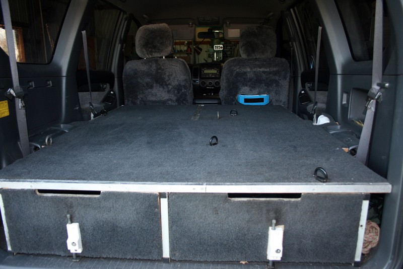

I made mine back in 2014 for the Dmax using the joiner pieces from Bunnings and the 25mm Tube from Capral Aluminium. Also all the sides in aluminium sheet. I had access to a guiliotine then which was handy. It worked out very well and is still in use. See the Two Videos by clicking on the link below.

The ones I built in Aluminium probably weigh about 25-30 KG's I certainly can lift the lot into the back of the Dmax by myself. I take the unit out once a year to clean the tray out as sand tends to get in there under the unit. Takes me about 30 minutes to get them out clean up and start replacing it all.

I have removed the middle seat and the two side dickie seats,these weighed 69 kg. altogether.
Made a set of drawers and a false floor,now I have heaps of storage.
I had titan twin draws in my Ute they are good but do take up a lot of space for what you can get in them they are also very heavy so I have changed to something lighter
