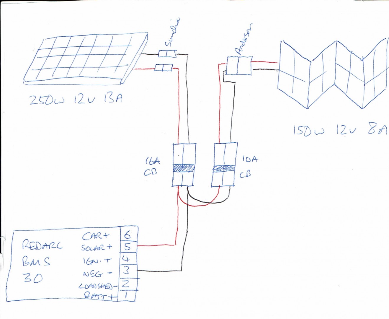

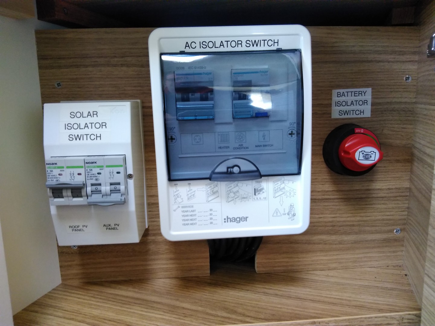

Yes I had an Redarc Manager 30 in my van and I was very happy with it. However, it only has one solar input, but that's not a problem as you just need to set up a couple of switches so you can select one or other solar panel, or parallel both together (for a cloudy day), before it inputs to the Manager MPPT controller.
The switches I used were DC circuit breakers so they served the double purpose of overcurrent protection and switching between the panels. They are on the left of the picture. I've also attached a rough and ready sketch to show how mine were wired.
PS: Use the thickest wire you can to reduce voltage drop. I used 6mm2 and regretted it. Would use at least 10mm2 if doing it again.
