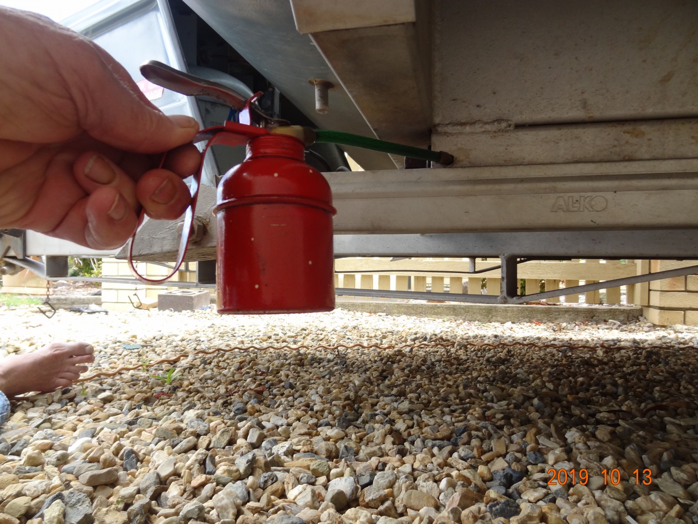

Can you take a photo of where the hole is please Cupid as I have the same problem on one leg only but cannot see any hole anywhere.
Cupie said
08:10 PM Oct 3, 2019
Will do when the caravan gets back from the repairer in a week or so (I hope).
Cupie said
10:08 AM Oct 14, 2019
Hi cjt55 ...
Got the van back after they replaced a few sheets where I hit a rubbish bin at Lakes Entrance. They did a great job but very slowly.
Thanks Cupid. Unfortunately mine don't have the hole.

Here are the photos as requested
