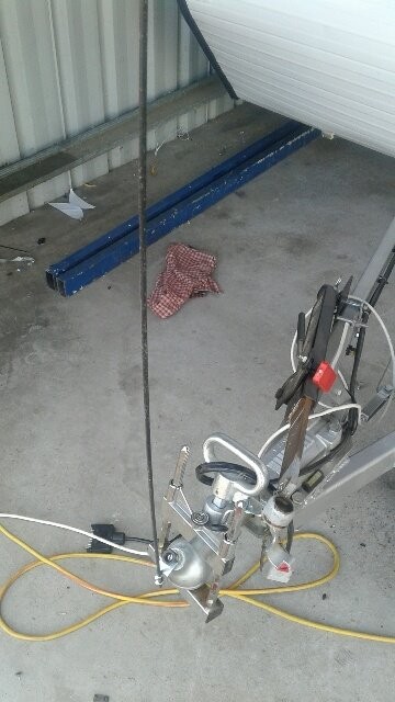

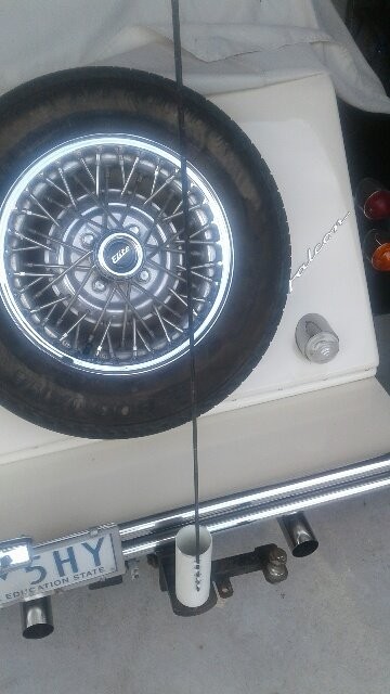

I also dont need a person helping me reverse my townall to the hitch. This set up cost me under $5. Line up the fibregalls rod until they touch, remove them and reverse 80mm. Lower hitch.

But mine raises the van to level and automatically hooks and unhooks the hitch. No need to wind up a jockey wheel or pump up a trailer mate!
