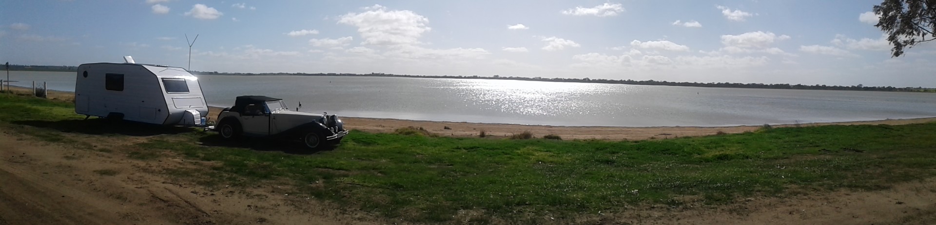

Eaglemax said
09:51 AM Aug 29, 2019
Craig1 wrote:
As Bill B, we got a modest increase in van gvm, which still left plenty below any regulations, chassis capacity,springs,tyres etc.
My tugs towing capacity needs upgrading from 850kg to 1000. Our van is 730kg tare , 1000kg atm. So these upgrades if nominal like 150kg in my case or 200kg in the case of large vans isnt a big deal.
Although we have capacity. We do not carry water in the tanks. Carry drinking water in car. Most places we go have water so no problems. If we free camp , we can manage without a shower for a day or so then head to a showgrounds or sportsground. After setting out to travel around australia, we only got 8 weeks in and strop was diagnosed with cancer. While strop is having cancer checkups we just travel the east coast So water is no problem. make the most of your life, its not a rehearsal. Enjoy.

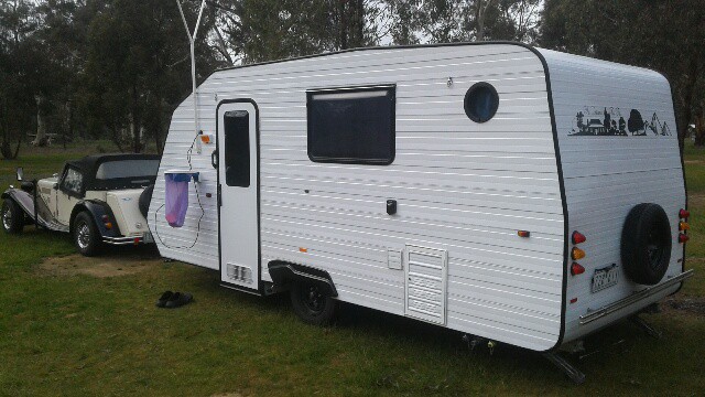

Eaglemax said
07:38 PM Aug 31, 2019
yobarr wrote:
Bobdown wrote:
I find it quite incredible from the posts above that many of you don't carry much water, why have tanks at all. I purposely added another water tank to our van so we could carry 300 litres, therefore free camp for longer. I also find it quite ridiculous that caravan manufacturers don't include full tanks or the weight of water at Tare. For them to give a payload of a low 250 - 300 kg and then subtract water and gas bottles leaving the owner with 100 - 150 kg for food and clothes etc. Our Tare is 2520 kg and ATM is 3200 kg, a payload of 680 kg which leaves 380 kg after the tanks are full, very doable. Cheers Bob
Hi Bob...Whilst I disagree that water should be included in the tare (It is,after all,part of the load) I do agree that it is hard to understand why some vans have a ridiculously low payload allowance.My ATM is over 1300kg higher than the plated tare,and with 420 litres water,6 batteries,all the Solar panels,30kg inverter,fridge,diesel heater,latex mattress etc etc I run very close to the GTM rating.And thats with all the beer in the other fridge,in the car!Cheers
-- Edited by yobarr on Friday 30th of August 2019 04:07:05 PM
Chris
Just for the sake of interesting observation
My tare is 730kg ATM 998kg full ensuite, 84 litres water
Your load allowance alone is 1300kg. Your water capacity of 420 litres (kg) os nearly half my atm.
I wonder what is not included in the tare?
When initially weighed do they include;
TV ?
Mattress?
Spare tyre?
Jockey wheel?
Jack, if supplied?
Gas is not
Water is not
Water in HWS is not
Some contrast eh. Tony.
