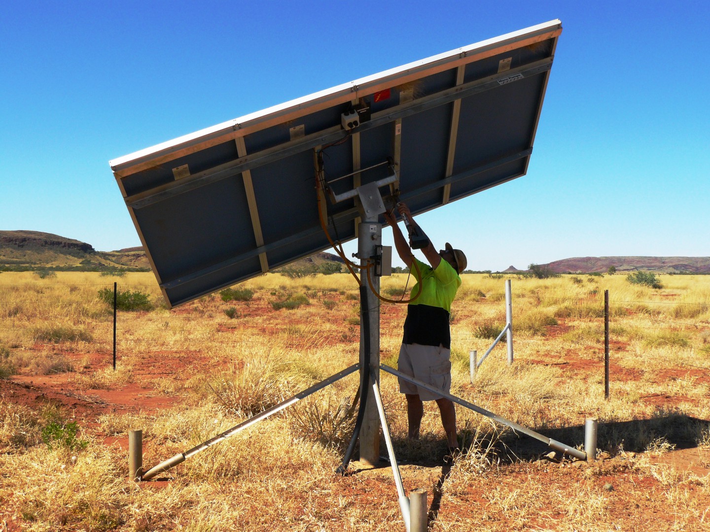

This one on a Pilbara cattle station needed regular "fixing". It was eventually replaced with a larger array of fixed panels.
