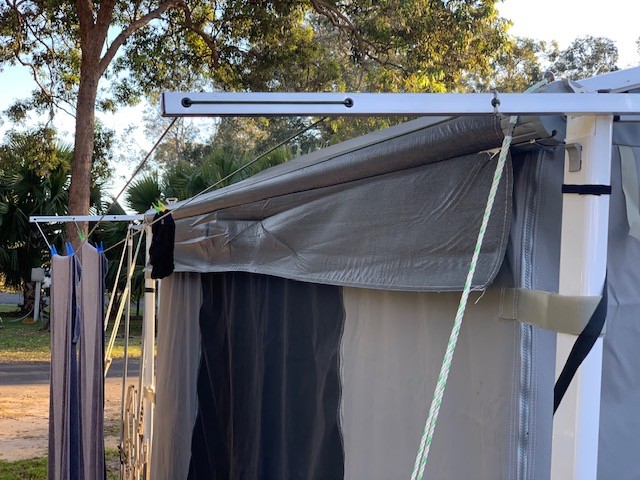

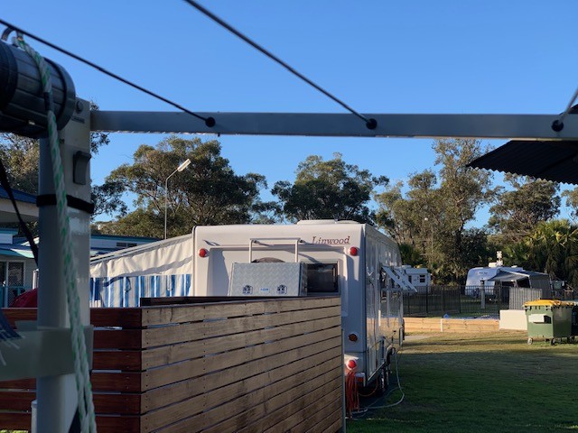

could you post a better pic of how you attached it to the awning arm
drtooheys said
03:08 PM Nov 27, 2019
pic 2 is a pretty good one. Basically there is two 25mm flat alluminium (x2) pop rivetted top and bottom which then slide over the awning arm, they have a hole in them drop a stainless bolt though tighten with a wing nut. Just a tip because of the gap between the leg and the arm I pop rivetted two bits of channel to hold the 900mm length solid away from arms otherwise there would be movement when line is being used. hope this helps the van is packed up with a cover on so more picks aren't on for awhile.

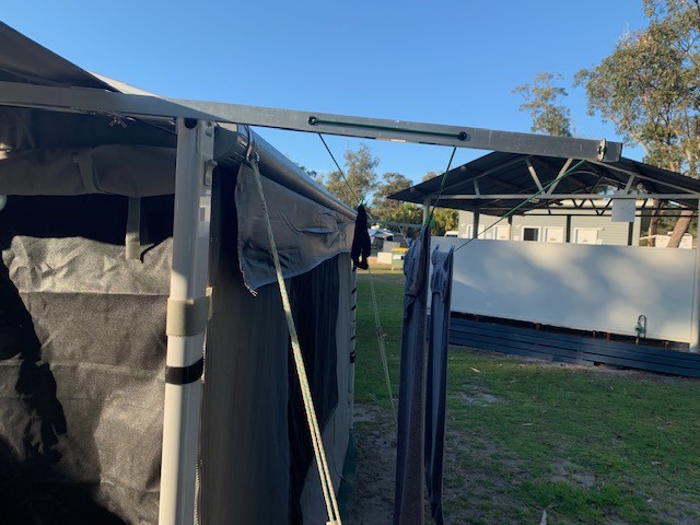

Eaglemax said
06:23 AM Dec 24, 2019
Good idea. I worry about people walking by hitting their head on things (usually me)
I came up with this idea. High enough to not hit my scone. It normally has two ocky straps for wind bracing
Tony
-- Edited by Eaglemax on Tuesday 24th of December 2019 06:24:48 AM
Came up with this. Can handle a few days washing and sheets as well, plus it wont blow over.
