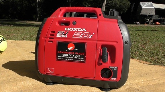

Hi all,
I was going to post this in tech corner but figured since the content of the video is not what I would consider technical in nature, I think it's better posted here.
I was away camping with a mate a few weeks ago and as I'm prone to making youtube videos of anything I can get my hands on, since we both had out Gennies there , well....you can guess the rest.

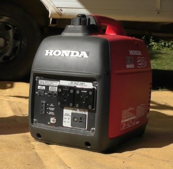

Mine is the yamaha EF2400iS and Steve's is the Honda Eu20
I thought this might be off interest to you vanner lot, since I think these 2 are towards the top of many peoples lists for something to power everything in their van all the way upto and including an AC unit. Although I know there are some newer ones on the market like the Honda 2.2kw

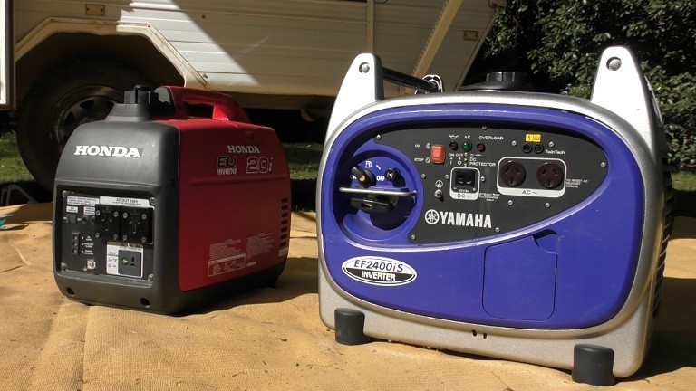

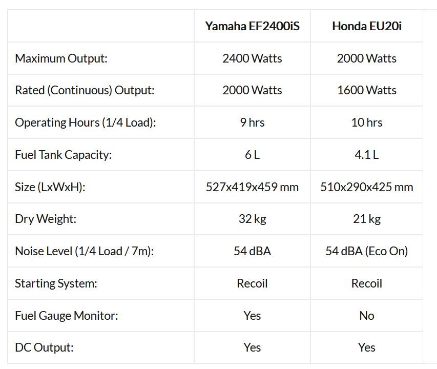

straight away you can see the size difference between the 2 and you will see from the specs below , the yammie is about 10kegs heavier

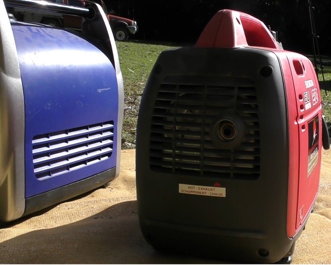

from a noise perspective, we both thought the honda was quieter especially when it was put into eco mode and despite the specs listed above

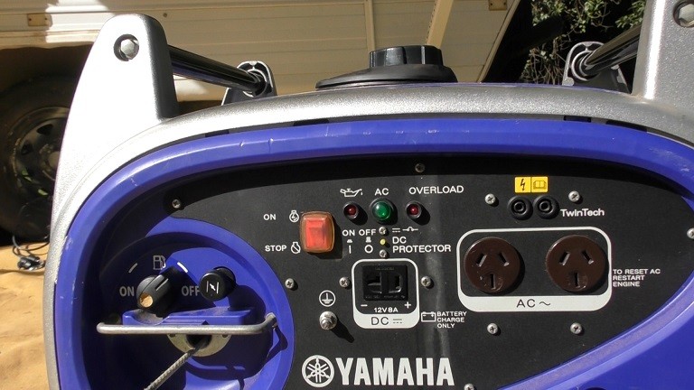

My unit is second hand and I was not aware it had an auto eco mode. It has never gone into it as far as i can recall.
When i first got it, it would have trouble staying running, so i wound the idle up a bit. Thus it runs a bit hot with no load and this may very well be why its never dropped into eco.
Both have very similar controls and I Beleive both can be paired up with another of the same unit to increase output. Neither of us have done this.
We have both used them for home use with power outages to run fridges or freezers and the like.
Mine has also ran a portable 12000btu( I think) aircon unit which it does without issue.
As with most, we have used them when out and about for battery charging duties via external chargers.
Controls on both are very similar and easy to operate
in my opinion the yammie is an excellent at home genny and whilst it will run pretty much anything you need in the field, it is quite the handful to haul around. The Honda is a bit better from a storage and lifting perspective but I would like to see what a Honda 1 looks and sounds like compared to these 2.
If you have one please let me know.
Im also interested what others are running and how you manage carting them around etc.
As both of us have plenty of solar, this was more for ****s and giggles that they got taken along and we knew we'd be camping in quite shaded areas.
As I try and make my videos entertaining, the main point is to try and be helpful to those who are interested to see such things.
With this in mind, I'd appreciate if anyone wants to comment on the video itself and share what you use and how you think it compares to what is shown. I think that could have real value for others checking it out.

The big issue for most with the Yamaha is the weight: 32kg dry but more like 37kg with fuel and oil is a hell of a lot of weight to lug around especially as we age - this is the main reason I went for the Honda.
This is a good time to mention a manufacturing fault with my Honda EU20i in regard to cutting out randomly:
Also there is a recall on the new Honda 2200 - something to do with a possible fuel leak.

I reckon the new 2.2 Honda is a lot noisier than the 2.0 it replaced. Is there anyone who has sat one beside the other?

looks like no guarantees on the honda. I know the non soft start units have a massive pull on start up, same as a house fridge etc.
I'd be dirty if the salesmen said it would run any of them and it didin't work. I'd be going back.
that was part of the reason I grabbed the yamaha. I'd heard those same stories about the honda struggling here and there. I would have thought they would have gone 2.4 or 2.5 just to trump the yammie.

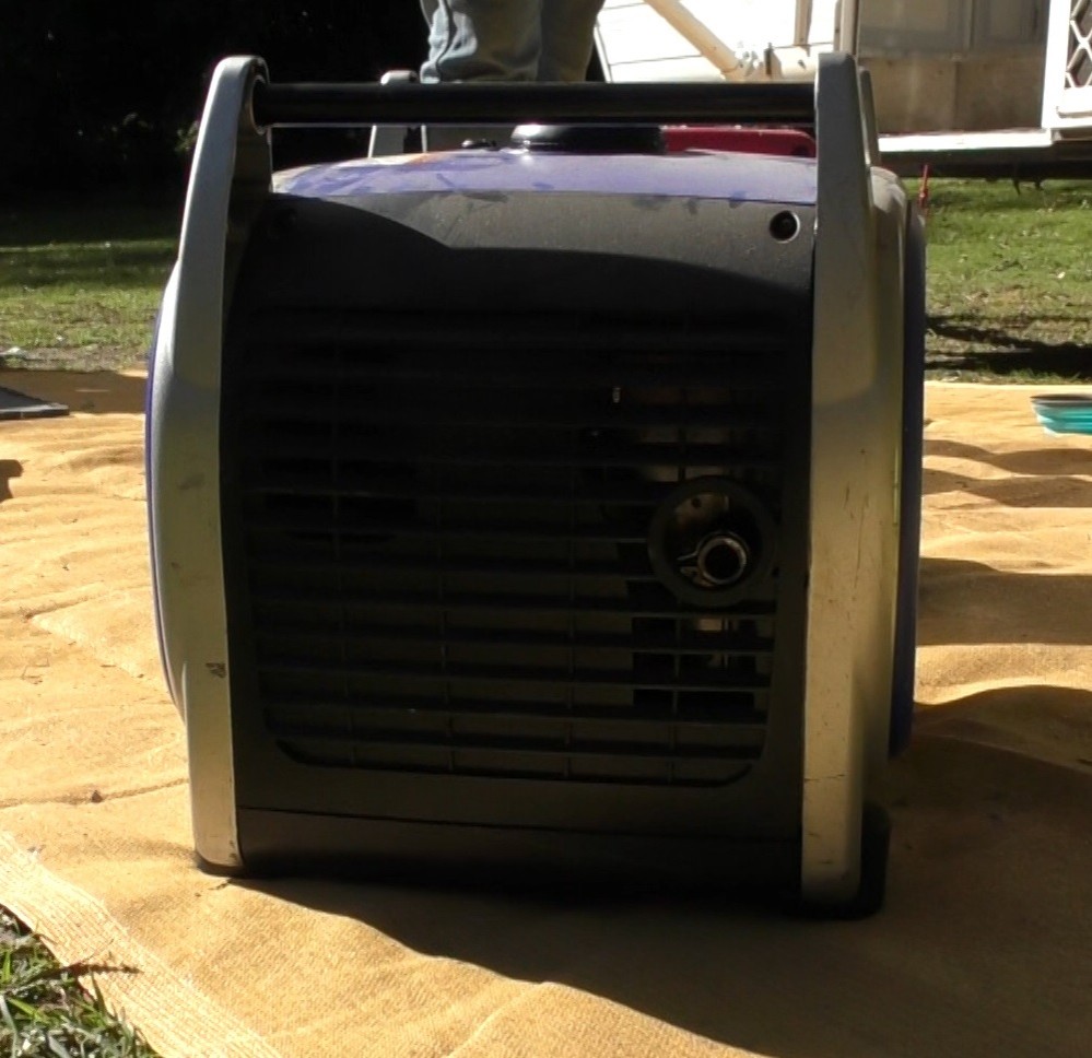

Mike, yeah it is a big beastie. As you see in the video, I tend not to carry it but push it around on a wheeled board. no point busting a valve fif you dont need to.
My mates honda on the day when charging his batteries was very erratic, we tracked it down to his campers charger switching itself in and out of line. once he made the change manual, there was a constant load on the honda and all was good.
you will see fuel on steve's honda also but that was just a spill, not a leak.
Thats very interesting Baggy, Its obviously bigger, but I wouldn't have expected that at all.
If I ever run into someone with one, I'll see if I can check it out and get some footage of it.
cheers all for the input.
