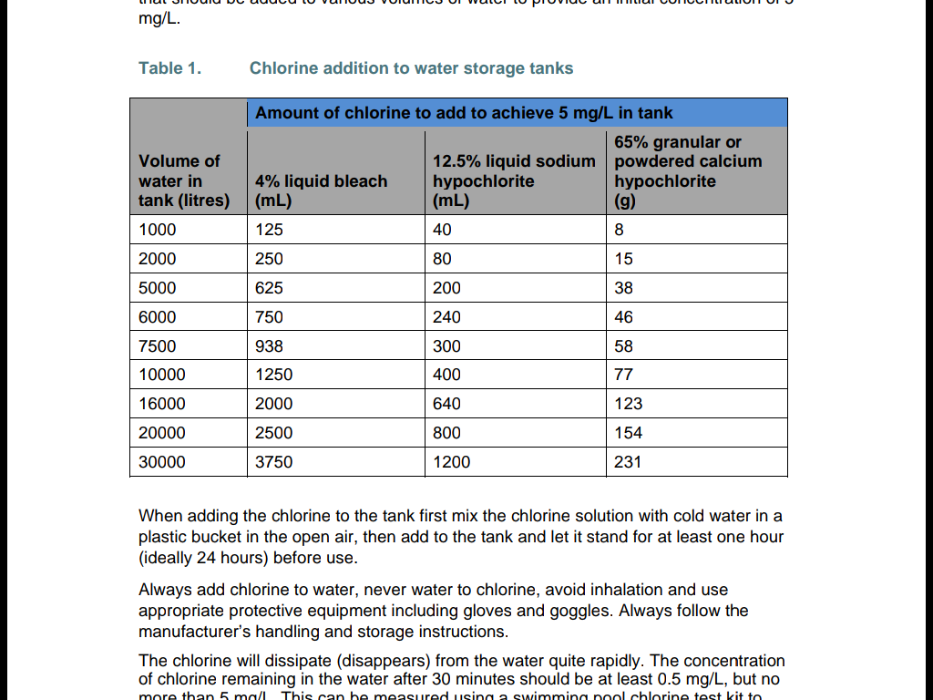

Domestos is a very cheap way to buy chlorine. If i recall correctly about 3 table spoons is all thats required for about 200 litres. Takes about an hour and good for afew days at least. But may not kill i think gardinia
See attachment
-- Edited by oldbloke on Sunday 30th of June 2019 12:58:20 PM
-- Edited by oldbloke on Sunday 30th of June 2019 01:51:33 PM
according to the UA EPA, Disinfect water using household bleach, if you cant boil water. Only use regular, unscented chlorine bleach products that are suitable for disinfection and sanitization as indicated on the label. The label may say that the active ingredient contains 6 or 8.25% of sodium hypochlorite. Do not use scented, color safe, or bleaches with added cleaners
See attachment
