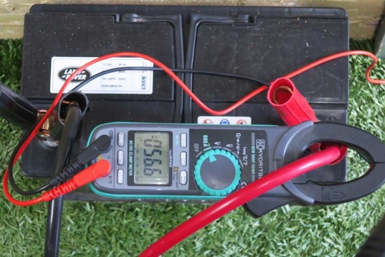

I'm new to it as well, my setup here: https//thegreynomads.activeboard.com/t65231112/custom-6x20-watts-solar-setup-with-mppt/
Alternators these day are smart so they don't charge all the time. They try not to charge when you need priority engine power for driving. They will charge going down hill. The engine battery probably hovers around an 80% charge.
I have wired from within the car which has very stable voltage, a Victron 10amp DC to DC charger set to about 13.8 volt output which runs at about 6 amps output. The circuit can do 15 amps.
I may buy a 24 volt DC to DC charger & feed it into the solar charger as it charges the batteries correctly. Whereas my DC to DC charger though stable output, it is not smart (charging the battery correctly as it gets fully charged).
Your solar cells are obviously connected to the solar regulator which in turn may or may not be connected to the car battery. Depending on what you want it to do, it maybe better to have it connected only to the auxiliary batteries where the charging is required when off-grid. You shouldn't need to have connected to the car battery as you shouldn't be using it to run fridges etc. Maybe have a switch so you have options.
Your 240 volt charger may or may not charge the car battery. Best to check using a multimeter, or better still, a DC clamp meter, brilliant things.
Doesn't matter how much you spend on a clamp meter it will be still cheaper than the hours you will need to pay for an electrician to get on top of your network. You really need to make a diagram of the network as is, then modify the diagram to what you want to achieve. Cheaper to do that than making numerous physical alterations. I had to buy a larger MPPT regulator even though the original one according to specs should have been large enough, not happy! At least I have a spare as a backup!
I hope your regulator is near your auxiliary batteries.
It could be that you have a well laid out system but it is nobbled by undersized wiring which seems to happen all too frequently in cutting costs, so things are not being charged as well as they could be.
Better you spend the time learning how your network works so when something fails in the outback you have a complete understanding or how it works so you can fix it. Otherwise you will be going through this whole process everytime there is problem.
Back to the questions, your setup, basically may or may not be charging things & the Anderson plug should be wired back to the source with at least 6 AWG wire & not through the car's wiring since you are charging 220 AH of batteries.

The solar being able to charge the crank battery is quite common & purely depends on the type of isolator fitted.
If it is a simple VSR , or ignition controlled relay, there is nothing stopping the solar also feeding back to the crank battery when the engine is running[.IF the house battery is in a high state of charge]
In fact, I had just such a set up on both van & motor home with a centre zero amp meter in the circuit. Over long drives, I regularly had the situation where the alternator had shut down & solar was actually running the engine & vehicle, etc , electrics.
The effect was most noticeable on driving from bright sun into the shade, when the solar would drop out & the alternator take over
On many occasions, we drove for hours with no alternator output.
