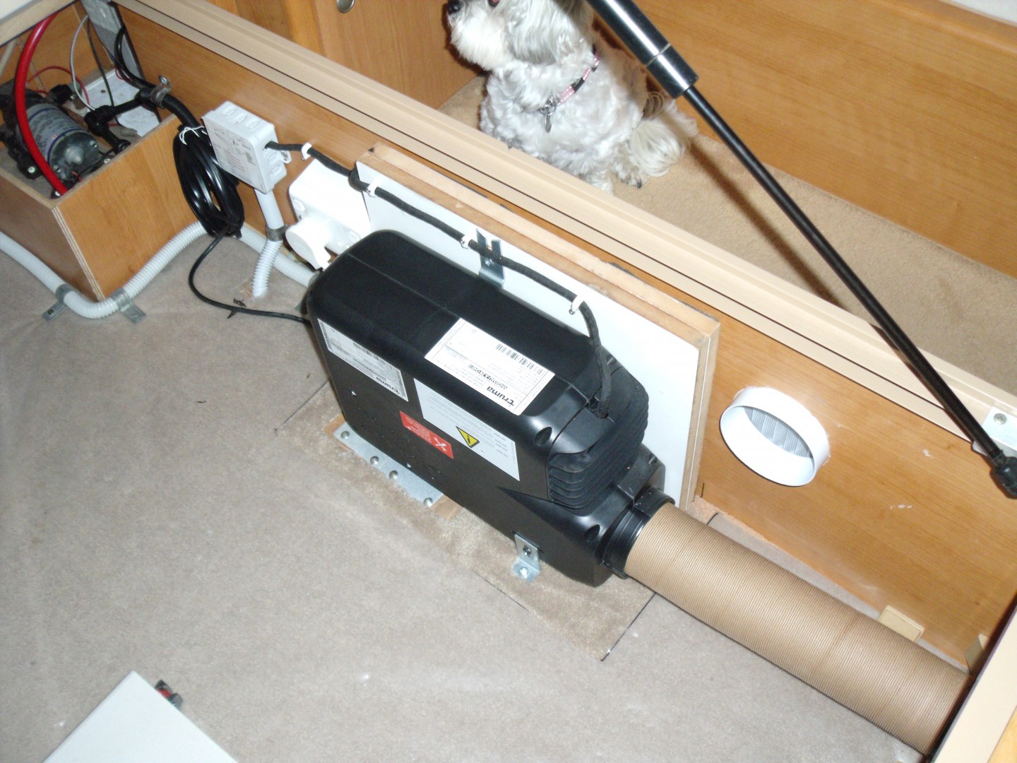

I have a Truma Vario gas one under the bed in our 18ft poptop, very efficient, cheap to run, no smells (outlet under van), night setting gives a low hummmmm, installed myself with gas fitter sign off after inspection. Simple gas install if you have gas nearby.
We have been using it in preference to our 240V ceramic one in Parks, quieter and more efficient.

I have a Truma gas heater installed under the bed. It is not as neatly done as The Travelling Dillberries' as it takes up more space than necessary for isolating from other surfaces, objects, etc. but it is quiet, economical on gas and very effective in sub-zero nights/mornings.

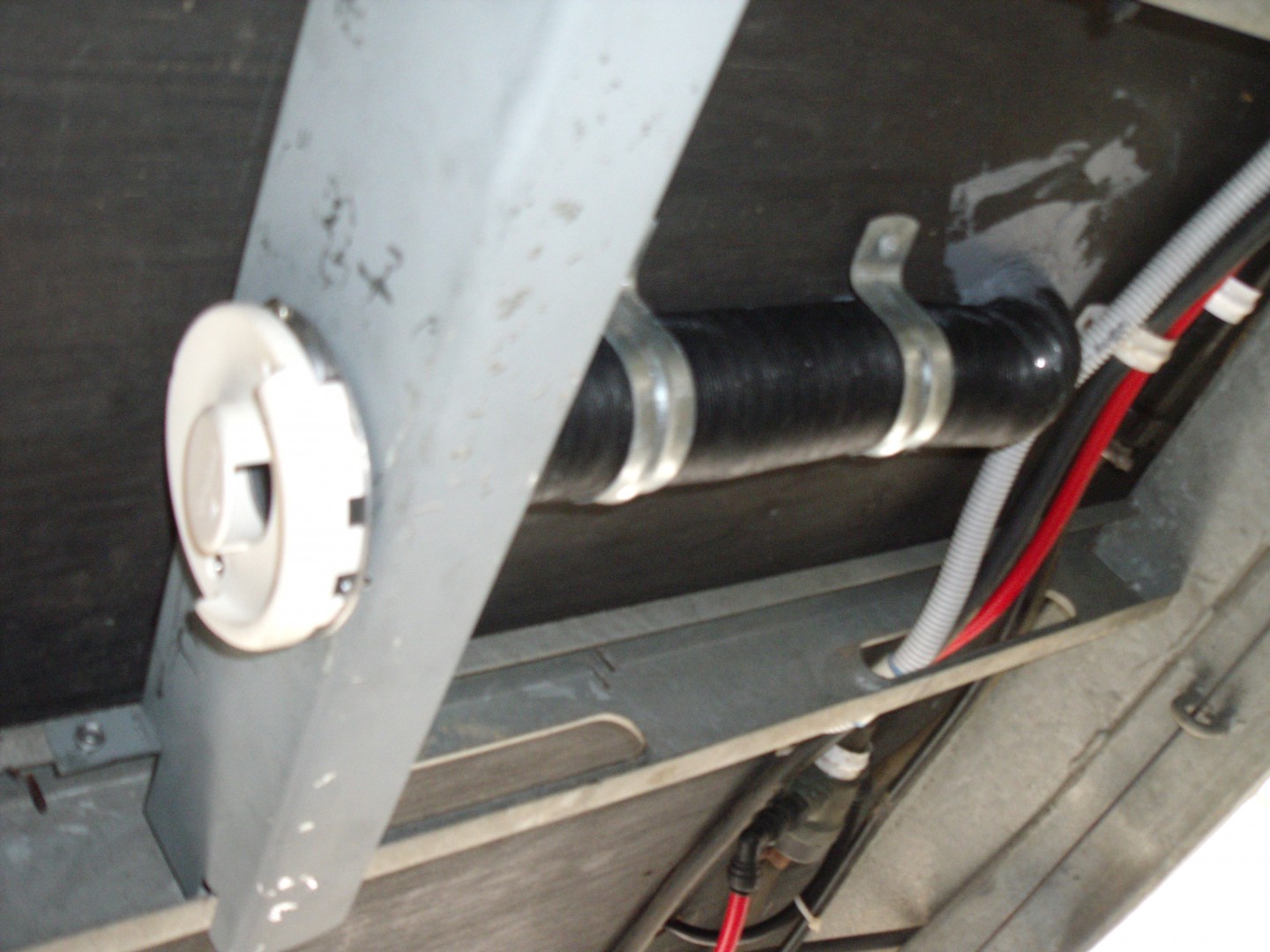

Is there any particular reason you added that cross-piece under the van to install the vent in? Does it need to be vertical and/or installed in metal due to the heat output? I ask because on mine I was thinking of just fixing the vent in the wall (fibreglass) or straight through the floor (wood). Thanks.

G'Day Mamil,
Instructions said exhaust should be mounted vertically in a wall or plate. Actual outlet has a smaller vent as well (you can see in the pic) that directs the exhaust down, away from openings or windows. So yes you can mount the supplied vent in the wall vertically, there a 2 pipes, smaller (exhaust) one inside and protective/heat one over it.
I went straight down thru floor which suited my heater location.
I also installed a direct connected 12VDC LPG alarm under the bed (near the power point) and a Carbon Monoxide alarm on the wall near the bed.

Thanks, and for the link to the installation manual. Yes, it says flue must be installed vertically, so I guess I'll go with the side wall. Have already got CO alarm, but would be interested to see your LPG one?
