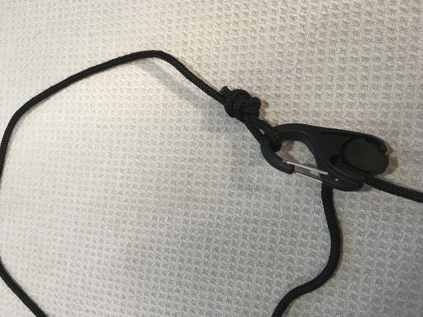

Hi, we have the same style of window on our van, and you are correct, they can blow open and pull out the shaft of the strut in strong winds. We found cam lock devices that we made up with cord and they can easily be attached to the top pivot point of the strut and around the catch of the window. Perfect in any wind. I must say that we are lucky in that our midgy screens are held to the frame with magnetic strips, and that makes it east to attach them from inside the van.
we found the cam lock things on eBay. Cant remember the supplier, but they are in Queensland. Good luck.

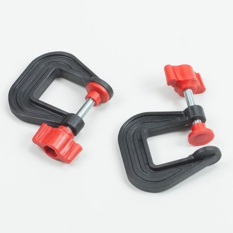

I have the same on my Adria van, and have been trying to find a solution. I've gone down a slightly different path and was thinking of some kind of small clamp on the strut itself, clamping together the inner and outer parts so it can't move. So far though I haven't been able to source something suitable, though I have found a picture of what I want. If anyone knows where I can get these, please let me know. The jaw opening is 25mm.
Cheers, Brownie
This might help.
https://www.niteize.com/product/camjamxt-aluminum-cord-tightener.asp

These camjams are available at the big green shed
