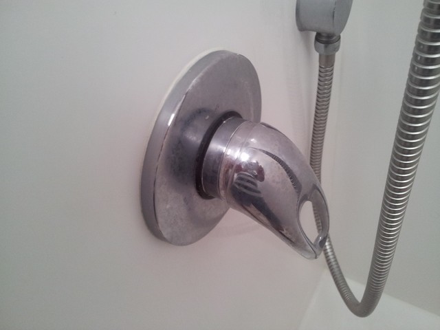

We are currently heading for QLD and are in Armidale. Had a shower this morning and heard water spraying in the wall cavity of the shower buggar.
Our van is a jayco heritage 2007 model, there is a removable moulded piece with hot and cold taps I am considering taking this off to have a look hoping to find the problem which I know is in the hot water line.
Any one else had this problem and able to provide advice.

Hi, we have just been down this road with our Concept, a broken john guest fitting behind the mixer tap, talking with my Jayco owner brother his said his 2005 Jayco had 2 taps on a panel, by removing 4 screws he was able to repair the leak but our case with a mixer tap only way in was via cutting small just above the tail lamps then covering the hole with a false vent.

PS: The photos on the second post show both sizes of the John Guest piping - 12mm black and red inlet and 15mm outlet from the mixer. Because the John Guest system simply pushes together you do not need a plumber to do any repairs.

Nice to meet a fellow grey nomad this morning. Our water problem was the John Guest fitting on the hot pipe of the hot water system. Have a safe trip to Clontarf and we hope to see you again.
