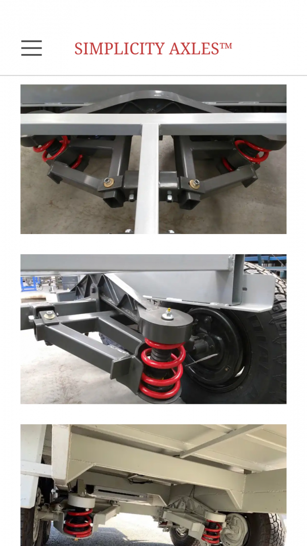

The only full load share Independent suspension I know of is the Leaf spring Simplicity design. They also now make a few newer designed Load Share Independent Coil and Airbags design suspensions as well.
BT 19' travel weight 3200 Simplicity Independent Load Share (leaf spring).
It has traveled approx 260K Off Road only replaced Pivot blocks twice and
saddles once. Would say easiest suspension to work on as only takes about
half an hour a side to do and no messing around with grease, shocks, any
other maintenance or worry about axels when off road.

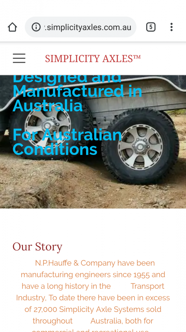

Made by N. P. Hauffe & Co.
Cheers Kev. (2K's from Home).
