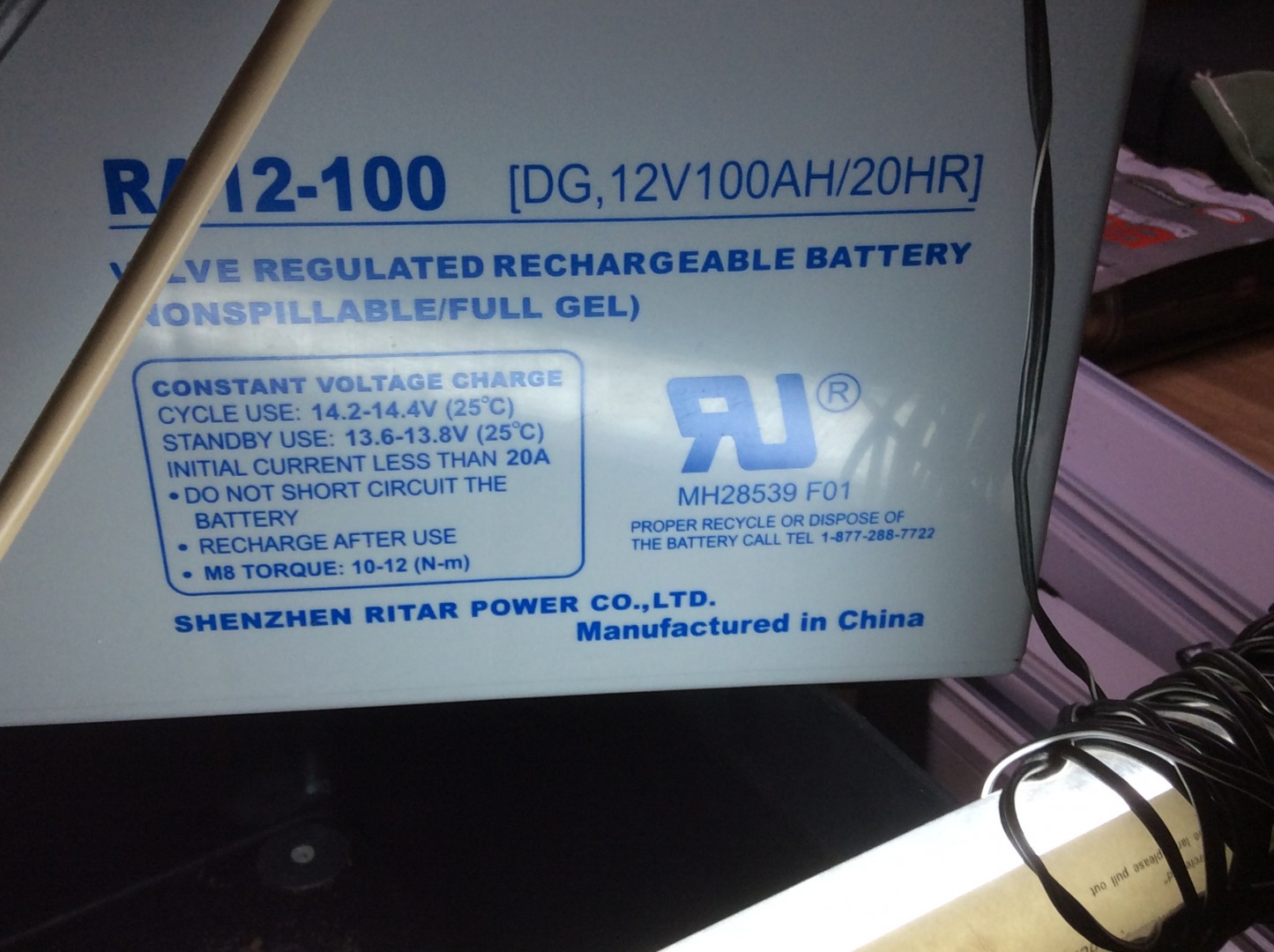

This is one that I will be replacing. Original supplied with van.
