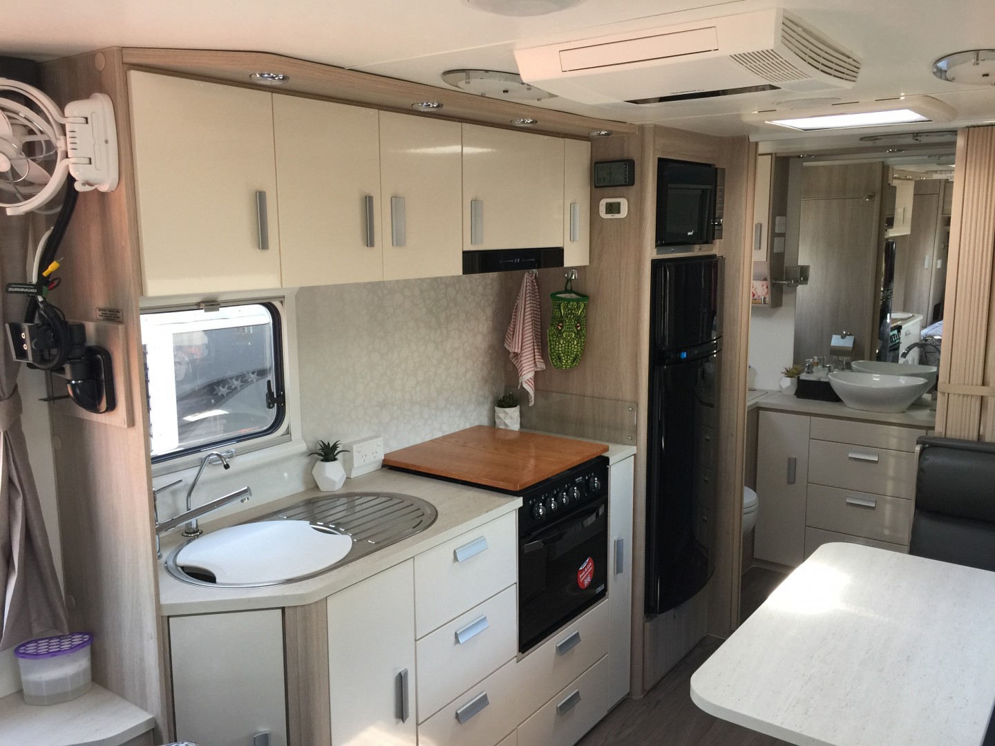

No worries at all with having AGM deep cycle batteries inside, they are designed for that exact purpose. Ours is under our bed. We have a 2017 Starcraft Outback TL 18.6ft and just love it !. For the price, you really can't go past a Jayco Outback model. They are really well made these days, and have all the exact same stoves, fridges, hatches, Windows, and many other name brand components of caravans $90K or more. Their J-Tech independent suspension (Pedders) and the chassis is super strong, rock solid and they tow beautifully.
