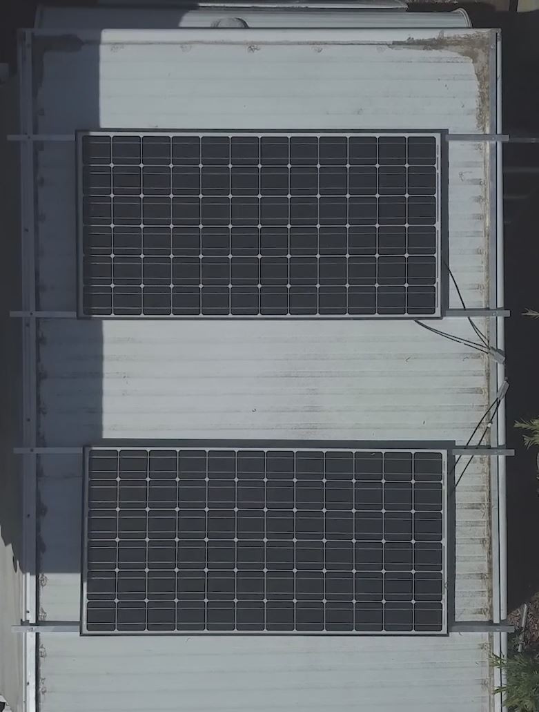

I'd always had an idea of how I wanted to do it and got my chance to try it out.

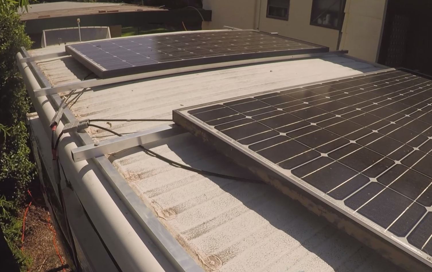

Since I have the pop top the center of the roof is a very light tin and is not capable of supporting the weight of the panels outright.
Luckily the outside of the roof frame is an aluminium and can support the frame work to support the panels
Underneath that frame leaves plenty of room for drilling through and bolting stuff to it
with that in mind, I wanted to create a roof rack style of frame which would add rigidity to the roof and provide support for the panels, all the while lifting them up a little to make sure they're not placing any weight on the centre of the roof and to allow some cooler air underneath for ventilation.

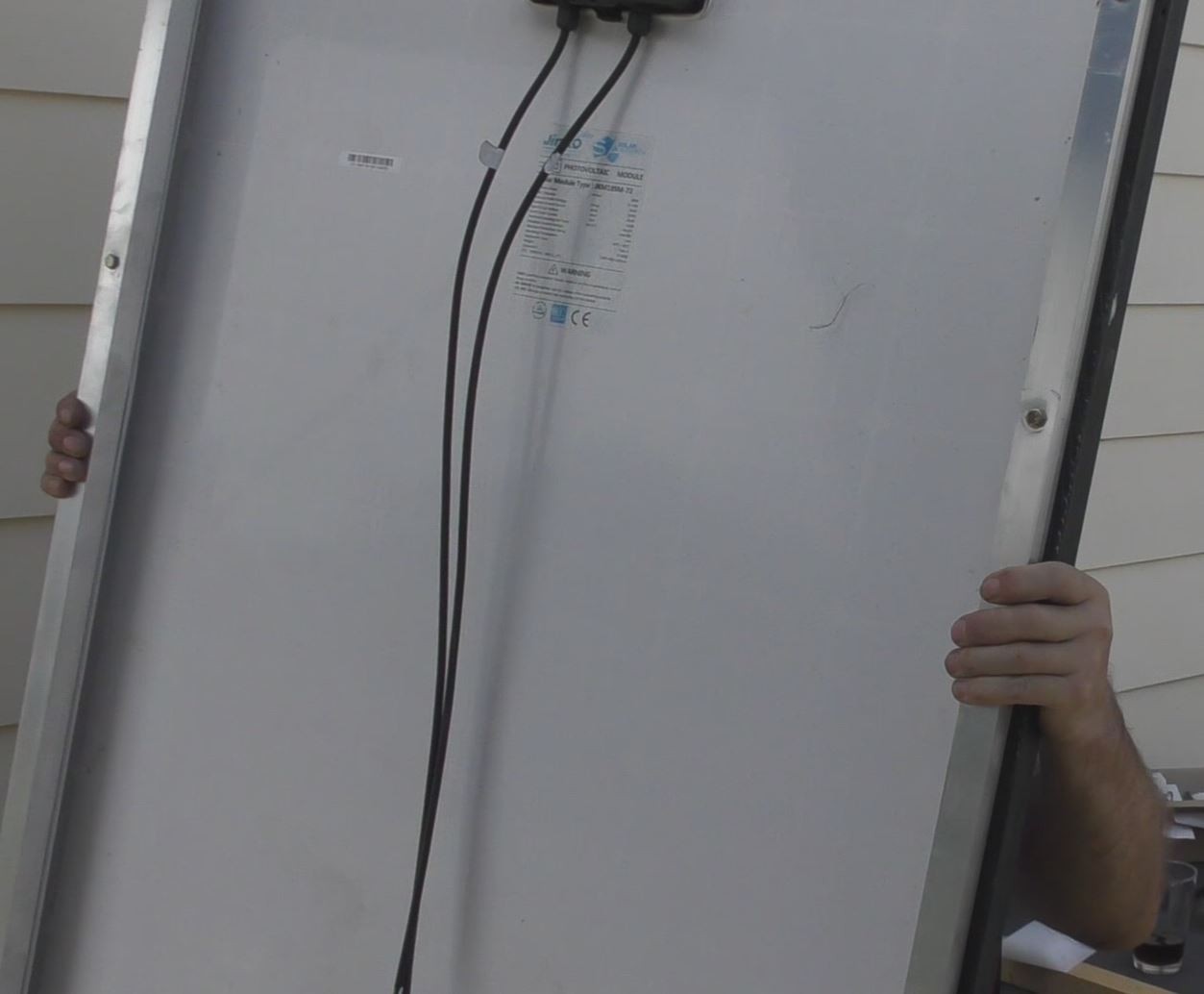

Bottom of the panels
Frame on the roof
I was very wary of height here but am comfortable that I haven't added too much to the top of the van.

So I opted for 2 x 185w panels at 15kg each, rather than the 2 x 235w at 20kg a piece.

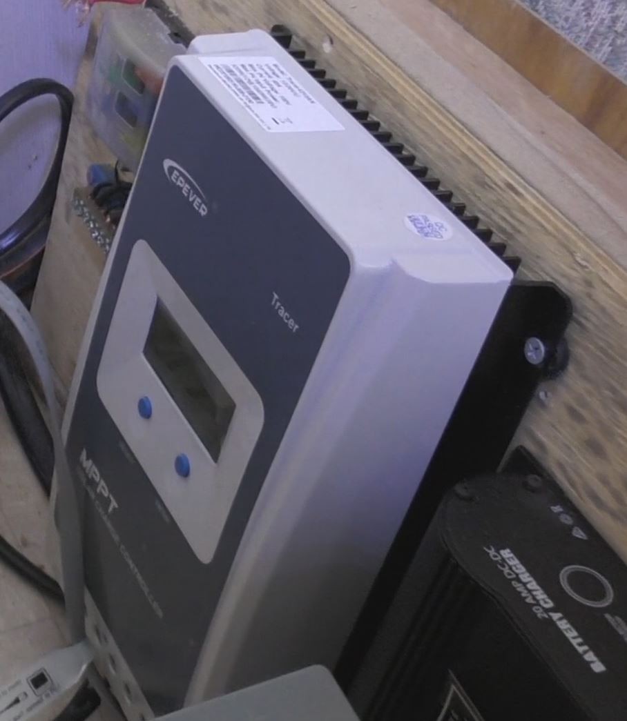

These are old house panels at around 40v and are set up in parallel and fed into my epever mppt 40A controller
This allows me some benefit when shaded and allows me to reduce the cable sizes for the runs down to the battery area.
I still have decent size cable though (using my previous lead for portable work) but I'll make up a more suitable length.
Currently, the cable is not permanently installed and will be plugged in and out as required.
I think I'll keep them running off Anderson poles though, to allow me to isolate or remove as required.
They'll also route through a circuit breaker soon enough.

As you can see below, I placed some separation between them to balance out the load on the roof, rather than sticking them up front or back.
This also allowed for me to keep the weight more toward the center of the van .

I ran the cables down the side of the van in 50x25 conduit & then into the van through the floor into the power compartment under my bed. I did put pictures (at your request) on the forum but it's going to take me a while to search for them.

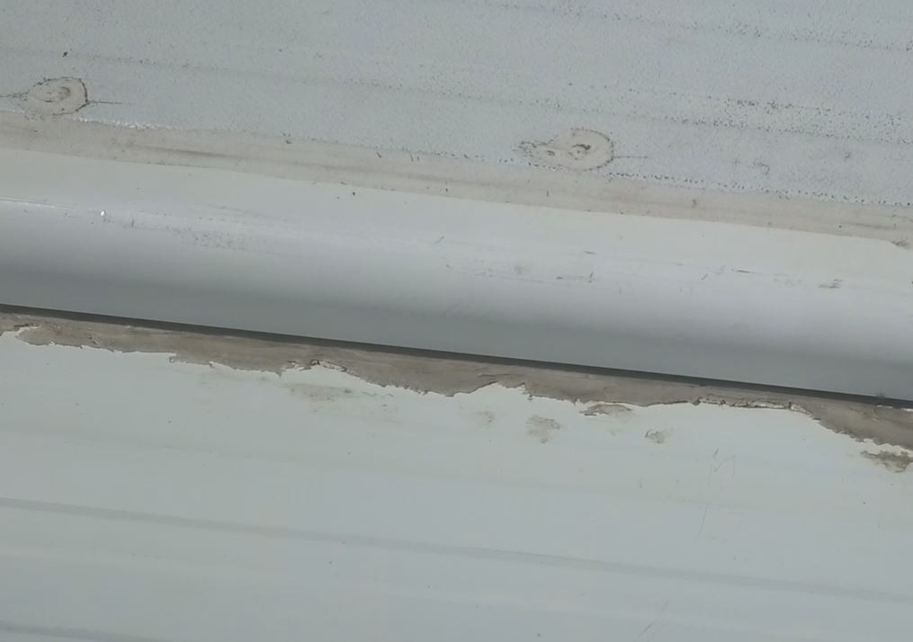

Advice from experience with the sealant D Mastic by Selleys Its does get fairly dry and eventually cracks . When older even a few years looses most of its abilities . However it retains slight adhesion and sealing qualities if undisturbed . Clamped between 2 surfaces is ideal 1-2mm gap . Examples of this are old school automotive heater boxes is an excellent use .
D mastic is not great for exposed movement prone joints . Besides its terrible to clean up .
A better and cheap product is SIKASIL named as Industrial but called RV silicon. Its designed to be used for van light construction and sealing . [ main frame construction use urethane = permanent fixing ] cost = 6$ from Bunnings order in. THEY might tell u uneed a box but that's B/S or Bradfast are the agents
Medium adhesion medium strength vibration resistant removable white black etc

The best adhesive seal by far for exterior use these days is Selleys Armourflex. It won't go powdery like Sikaflex, doesn't need anything more than a clean down with a metho to get it stick and to smooth off the finish, and is available at Bunnings.

Where the OP is placing the sealant it wants to be easily removeable. The Sikasil Industrial fits the bill exactly. The Armourflex i suspect is for more permanent join .

This is just what I had on hand at the time.
I've been away in it with some wet weather and am happy to confirm there are no leaks :)
As it progresses though, I may have cause to pop a few more holes up there, so will suss out the Sikasil . Thanks Swamp.
Terrry, Swamp is right, I don't really want to lock them down with an adhesive.
It might be handy on the end bolts though for the 'rails' . I figure they probably won't be going anywhere and are likely to be a permanent fixture.
