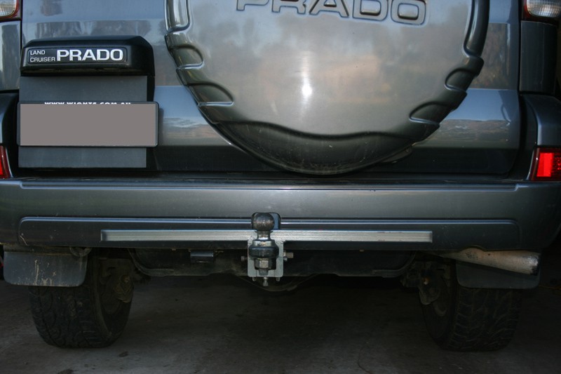

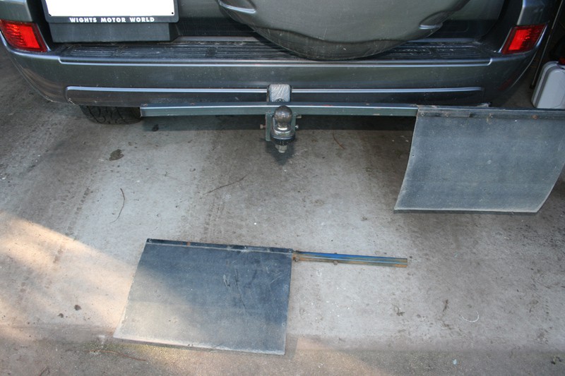

denmonkey said
01:48 PM Mar 22, 2019
By the end of the weekend, I will have finsihed my DIY version. I made it a while ago but the rubber I used was too thin and it shredded itself under normal use. I picked up some new rubber just yesterday and will be swapping it in this weekend. Once I've got that done, I'll stick up the video showing how I did it. Really very simple though. a bar, u bolt, rubber and some screws. Done in under an hour
this ones not mine but you get the idea.

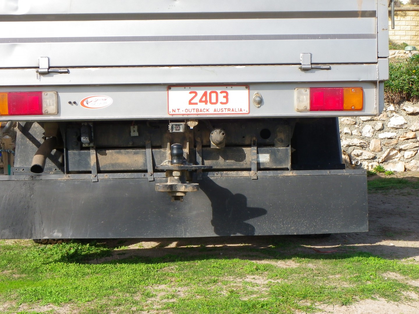

I bought two antispray Mudflaps from a truck accessories place Cut them basically in half and fixed them between two lengths of 20mm mild steel I had galvanised. Gave me four widths that were then mounted just behind the original mudflaps. Covered the whole width of the vehicle.
Does the job well and an added bonus cuts the spray as well. I think it cost me less than $100 in total excluding the stainless bolts I had on hand.
The Mudflaps are fairly easy to cut. Not Rubber anymore some sort of Plastic, A good Stanley Knife works well.

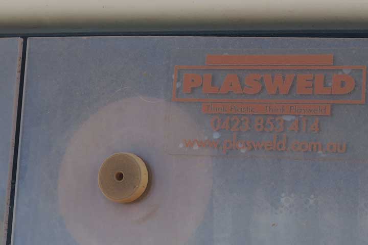

If you want to see out the rear window. Get a piece of 2mm polycarbonate (NOT acrylic) from a small plastic suppler in an industrial area. If you score it a few times each side with a Stanley knife it will snap. Sand edges with Norton wet and dry paper with water & drop or detergent or soap to make the water wetter. (not the rubbish the big hardware store sells).
If drilling, take a slight edge of a drill bit to stop it biting into the plastic. Then use a Sutton Tools C101 deburring 90 degree counter sink to tidy up drilled holes.

That was precisely why I used anti spray mudflaps instead on conveyor belt rubber which some one else said is very durable. Never had any problems throwing stones and or gravel at other road users and if you get debris from the person in front on a dirt road You are too close behind anyway.

I made my own Rock Tamers - similar to what denmonkey showed above.
The flaps are 2xHD mud flaps (per side) from Supercheap ($14 a set, I recall).
As noted above, do not make them full width! They also prevent stone chips on the car too.
