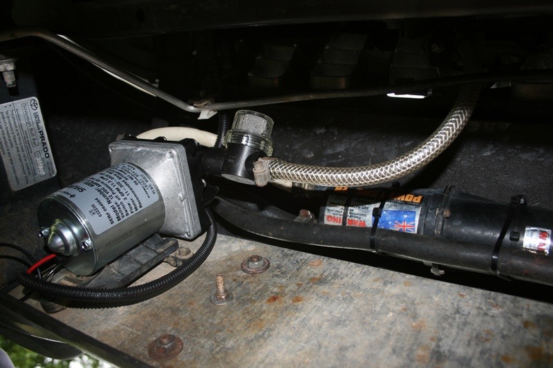

I pump water from almost anywhere. I carry a normal RV pump to do that because they will self prime and it also serves as a spare for the camper. We don't filter water gong into the tank at all but we do chlorinate all water and we have twin 10"filters after the pump in the camper and before the taps. They are a 5um sediment filter followed by a 1 or 0.5um active carbon/silver filter.

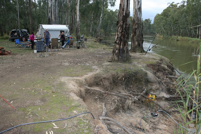

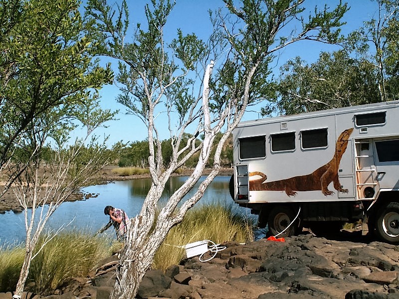

Only take river/lake water for shower etc and filter sediment out before it goes into tanks.
I can take genny to river and use 12V outlet to pump water direct to van (have pumped 45m hoses). Use two pumps,, a tiny whale submersible (on a stick into water away from bank) and a spare Shurflo for longer distances.
Other wise I pump into 180L tank in ute with 12v from ute.
Simple set up works well and no problems in 11 years.

I think it best I utilise the genny, buy a second joolca pump (thanks Peter) so it is a spare for the HWS. Buy an inline filter, pump thru filter to cubes, trolley them to van. 2 cubes per trip = 2 trips.
If close to the water can pump thru filter direct to tanks.

I bought the Joolca package that come with extra power leads, pump and hose as well as shower hoses. As I mounted the Joolca on the rear bumper, I use the pump to supply water from what ever source direct to the Joolca, I dont pump back into my tanks, I want to keep that water drinkable. I fitted a 2nd 80l tank and plumbed the house pump through a ball valve to the Joolca for if/when I want to use tank water, and I do when I know I can top up in a day or two. A 20 litre plastic drum will give you and the boss a reasonable scrub up. We practiced at home. The Joolca is great, but dont get caught like I did first trip away, everyhting was working, igniter clicking, no hot water (for the next 2 weeks). Batteries (2 D cells) were not fresh enough to open the gas valve.... I finally read the manual.
