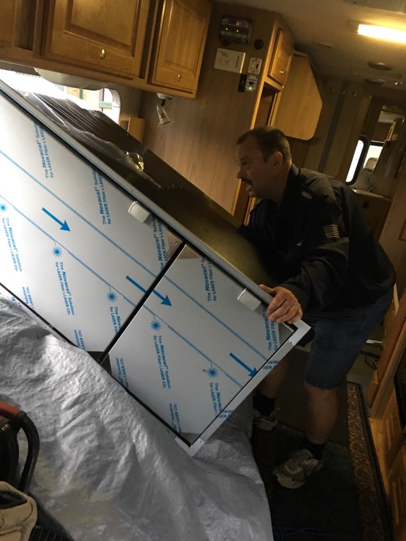

Even in motorhome its a big job .. Through
side window . Was actually easier than I thought !!
