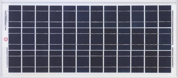

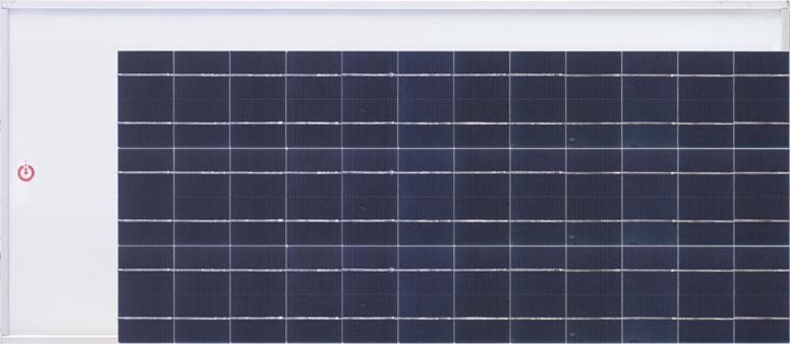

My 6 panels, 120w total, are producing a bit over the manufacturer's specifications, up to 135w under perfect conditions with water cooling, but often 127w square with the sun midday in summer in Sydney on a clear day.
But looking at it from a different perspective of watts per square metre. The actual cells only cover 72.7% on the panel. So the overall foot print in not overly efficient.
My needs were a panel had to fit a certain space when stored on the roof. When open on the ground I was not worried about the efficiency per square metre.
If you have panels fixed on the roof you will want good efficient per square metre of the actual panel, not the cell as is generally stated by the manufacturer.
Cells moved with Photoshop 72.7% of the overall area.
