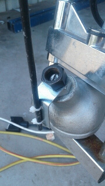

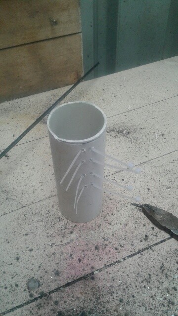

This will cost very little. Made it up in 30 minutes.
You get a short section of 50mm pvc tube, a couple of 1000mm lengths of dowel or fiberglass rod, a bracket, a nut for your towball adjustment bolt and you're done
. Line up the poles as you reverse.
Tony

Some pretty good suggestions out there about to how to get the towing vehicle close/hitched up. But I doubt you'll get much better than a strategically-placed reversing camera with sight of the towball. Just my 2c.
Tony
