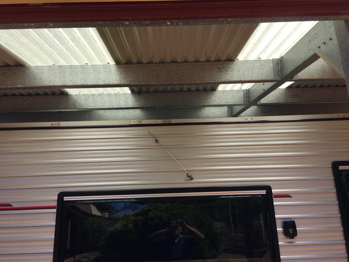

Not exactly the same thing but not sure if you have solar on the coaster, but in my case I have 2 x 150 W on the roof of the van which is parked in a gable roofed carport when not in use.
I installed 2 clear Alsynite sheets over the solar panels which is North facing, my van batteries are constantly 13.2 V to 13.5 V trickle fed with about 60% SOC on a sunny day. I power the fridge up
2-3 days before we go away and rarely use 240 V power from the house, works a treat.
