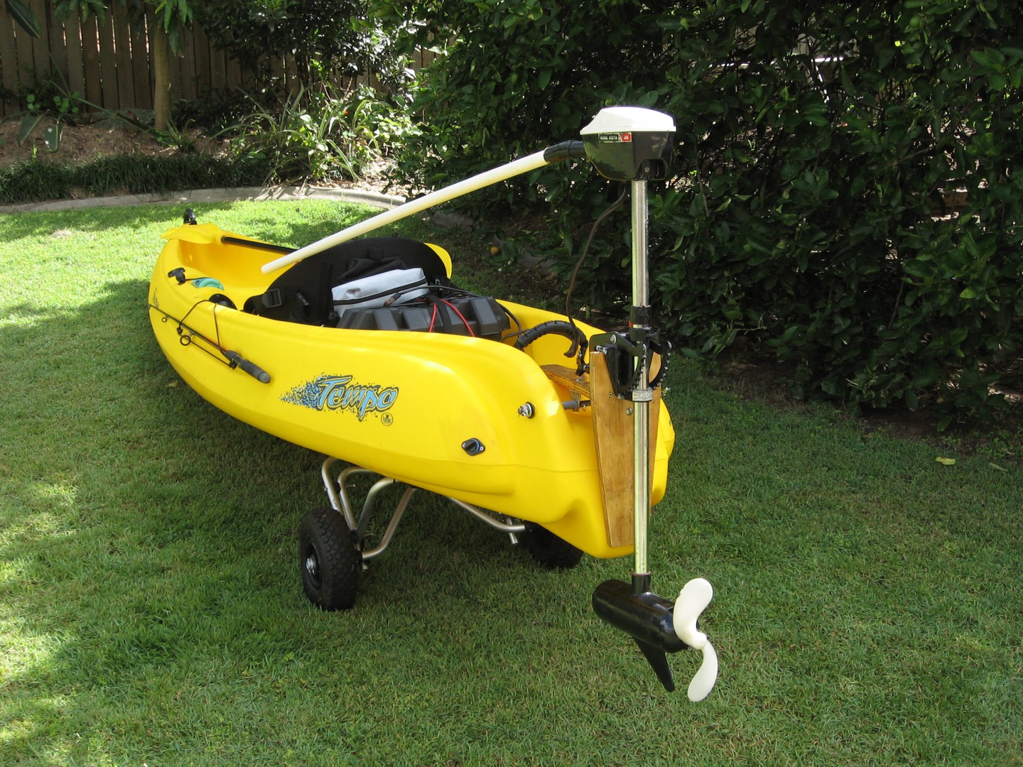

I am looking seriously, again, at fitting an electric outboard. I now have a very portable 50Ah Lithium battery available that will sit behind the seat.

Gave the outrigger idea away and have mounted a simple transom for a little WaterSnake. I do Wivenhoe and the Brissy river from the spillway to Koholo a lot. Multiple wraps on the shaft and an anchor trolley type setup for steering gets me a long way in a mostly straight line, effort free. The 50 Ah Li only weighs 6.5 Kg. The iPad goes in a sleeve good for 3 metres and half an hour and I can operate the GPS through the cover. iPhone is in a similar cover and kids have installed Find your Phone app if I do not check in once an hour.

Iza, re ( have mounted a simple transom for a little WaterSnake.)
Any chance of a Photo, I have a small watersnake and a 100 Amp lithium battery ex my 2.7m inflatable boat ( now have a 3.3 HP Merc motor) for possible fitment to my Yak.
Peter ...
Found this commercial product that may not be too hard to replicate
Found another where the guy rambles on and on, but his approach was to insert suitably sized conduit into the rear rod holders & bolt a bit of timber to them that protruded over one side of the yak as a mounting point. A bit rough but doesn't require any drilling of the hull.

Thanks Cupie am also looking at the unit below, do not know if the rod holders are strong enough and having the motor on the side rather than the stern, how much that impacts forward progress.
