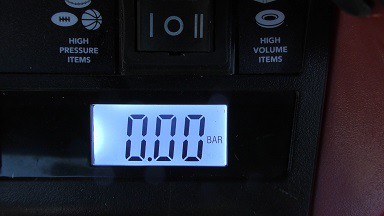

One trick it does have up its sleeve is to be able to set the desired pressure on the screen, start it up and let it go.
It will stop once it reaches the desired pressure.
My tests show it will go 1.5psi over the selected pressure, stop and then drop to 1.5psi under.
You can obviously make an adjustment to your selected pressure, if you cared enough.
It does allow selected of kpa, psi or bar.

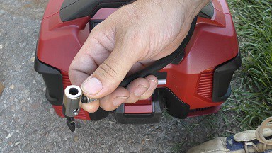

Everything you need is stored onboard on the unit as you can see from above.
So other than needing a charged battery, if you're not near 240v, it's a piece of cake to pull out and use.
Granted the thing is not perfect but those things still aren't what I'd call cons as such.
firstly there's a whistle out of the hose when using the high volume pump (example in the video) .
I'm not sure if this is just my unit or indicative of all of them. I've heard similar on other bed type pumps.
Second, the little cover over the included adapters is a stiff plastic. I'm not sure how long this will last after being taken on and off a few times.
Still, they fit in snuggley, so even if the cover breaks, theyre not going anywhere.

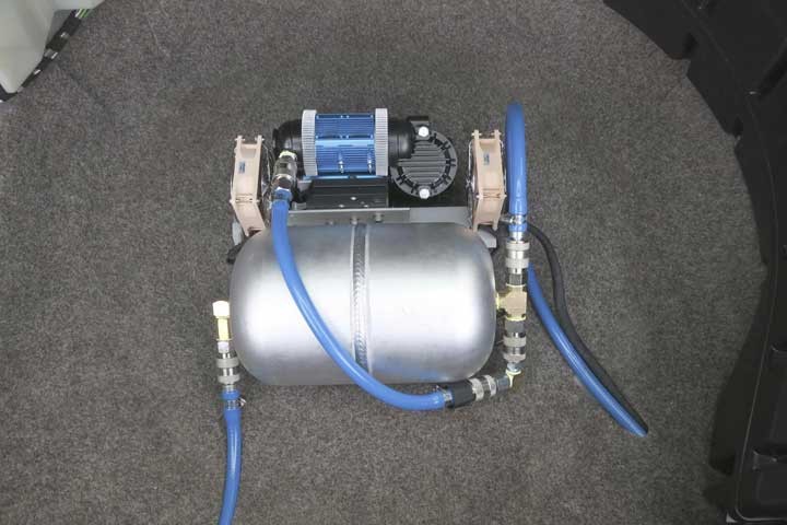

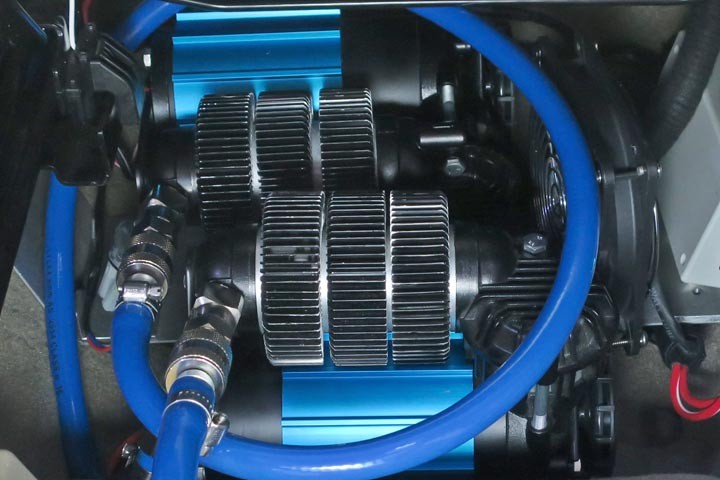

I have 3 of the ARB compressors & run the engine when pumping up tyres as the 3 use about a 100amps. What is the duty cycle of the Ozito? Most cheap compressors would only have a 25% duty cycle if you are lucky, so 1 minute pumping then 3 minutes off or you will cook the compressor. They get extremely hot.

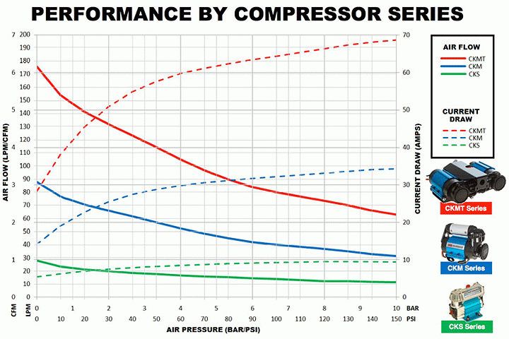

This ARB chart shows the volume reduction with increase in PSI. Also do not forget the first atmosphere has to removed from answers.
If the compressor has enough volume & pressure it is great for blasting dust off the car. Also using it with a vacuum for getting dirt out of carpet in the car. It dislodges dirt far better than vacuum alone.
Yes, a 4wd compressor it ain't, but for the small stuff, tis a handy unit.
3 ARB compressors will do 60 litre tyres, 20 to 35 PSI in 30 seconds or O to 45 PSI for the spare in 90 seconds.
I also use a moisture trap, it is surprising how much water is in the air in humid conditions. If you can, run the compressor within the car to take advantage of air conditioned air, it will be drier & cooler so it will carry less moisture.
An air tank will also help remove a bit of moisture from the air if the tank is cool.
As a rough guide you will loose about 1% of compressor resources for every connection, right angle bend & every metre of air hose.
Run the engine while using the compressor to keep the voltage up. Replace the original 12 volt leads with 6AWG.
I'm loosing 7% on my setup as 6AWG is a bit too light for the 100amp load & cable length.

All compressors should state SCFM, standard cubic feet per minute. Simply stating CFM & or PSI is a meaningless statement at best. It means CFM at no pressure & the PSI at zero air flow. Utterly useless!
You basically need to know how many CFM you get at 90 PSI. This is the industry standard & a good all round reference.
X litres at 30 PSI is a next to useless comment. You may pump up your tyres to only 30 PSI but it no where near enough to allow for resistance in your entire setup, & the next 5 PSI up to 35 PSI is a lot more work for the compressor.
So ask what is the Standard Cubic Feet Per Minute is! If the manufacturer cannot tell you do a lot more research, or as a best guess divide the capacity of the compressor by let's say a factor of 10 as a starting point!
Ask for the compressor's Duty Cycle, anything less than 50% duty cycle forget about it. ie 1 minute on & 1 minute off.
If you need to blow up large low pressure items use a venturi blower on your compressor to multiply the air volume but it will be at lower pressure, but that is the point.
The ARB chart above is still vague but it is streets ahead of any other manufacturer that I have seen to date.

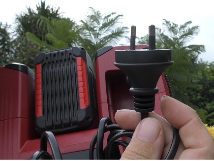

As you can see from the pic above, the compressor will run off the power xchange batteries that I have for the chainsaws and pruners etc.
As a bonus though, it will also run off 240v from the power lead which is stored underneath the unit

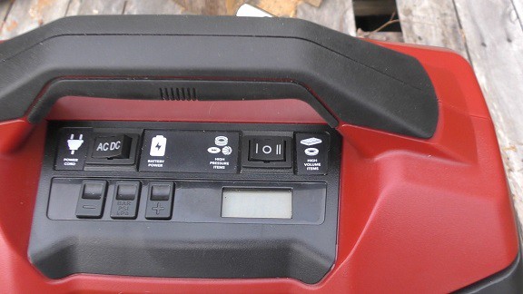

The unit actually houses 2 compressors internally which was a bit of a surprise.
the first, is similar to any small car compressor you may have in the boot of the car or have used for inflating the kids bike tyres or balls etc. using the 'high' pressure side and the included bits.
This is limited to 160psi and performs as expected in relation to speed.

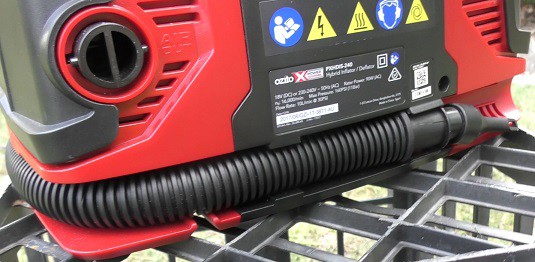

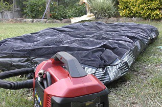

The other side compressor (low pressure /high volume) is more akin to a compressor or pump you would use for air beds and camping type duties.
The hose it stowed on the bottom of the unit.
To inflate, stick the hose on the air out side. To deflated, stick the hose on the air in side. Simples.

In addition to the usual tasks, it can also be used as to blow out dust and similar like I did with my old mans dust laden computer.
I'm also keen to press it into duty for getting a camp fire started :)
